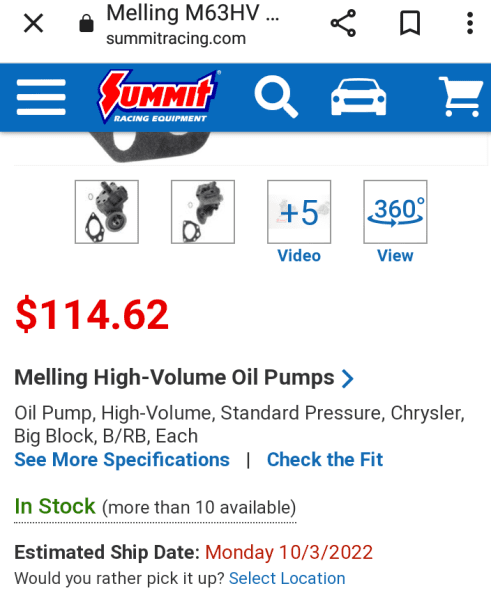

This is for big blocks, but shows it as being a high volume/standard pressure.
I was looking at the Melling pumps as my choice for this job. The M72 and M72HV are the small block pumps. Some of the pumps I looked at say they are "standard pressure", but when you compare the pressure specs, they are actually significantly higher than the stock pump (60-70 psi). If memory serves, the stock pumps produce about 50 psi (?). I have not been able to find the Melling pressure specs yet.
However I did notice that the high volume pump is higher by 1.5" (to accomodate the longer rotors used to create the higher volume), which I expect would mean a change to the suction tube is required if a high pressure pump is used.

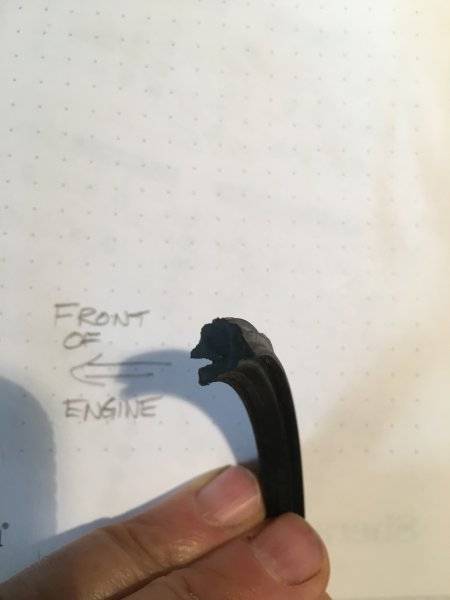

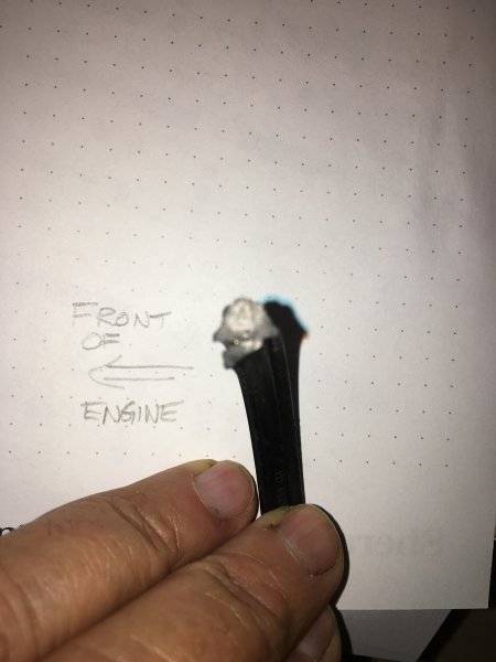

Also, got a question on seal orientation. My seals came with no instructions. The pictures aren't great, but hopefully enough to see the orientation. Do I have the seal oriented correctly with the lip wiping on the crank pointed toward the front of the engine?

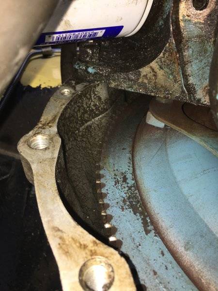

Well spring is here and I am knee deep into the rear main oil seal job. Having a horrible time getting the oil pan off (see other thread), but that aside, I am wondering if the seal is the culprit or not. When I get drips under the car, it is dripping at the inspection plate on the front of the bell housing. It certainly appears to be coming from within the housing, as opposed to running down the outside. Hence why I was convinced the oil seal was toast.
However now that I have the entire dust shield off, I can see that the front of the ring gear is absolutely dry. There is oil and dirt buildup on the inside of the housing around the ring gear but the gear itself is perfectly dry.
So the question i have is with respect to what would I expect to see if the rear main is leaking? I kind of expected that you would see oil all over the front of the ring gear. Is that a wrong assumption?
The dust shield was dry on the internal side when I removed it.
So from your experience with bad rear seals, what would I expect to see - or how would I more firmly diagnose if its the problem?
