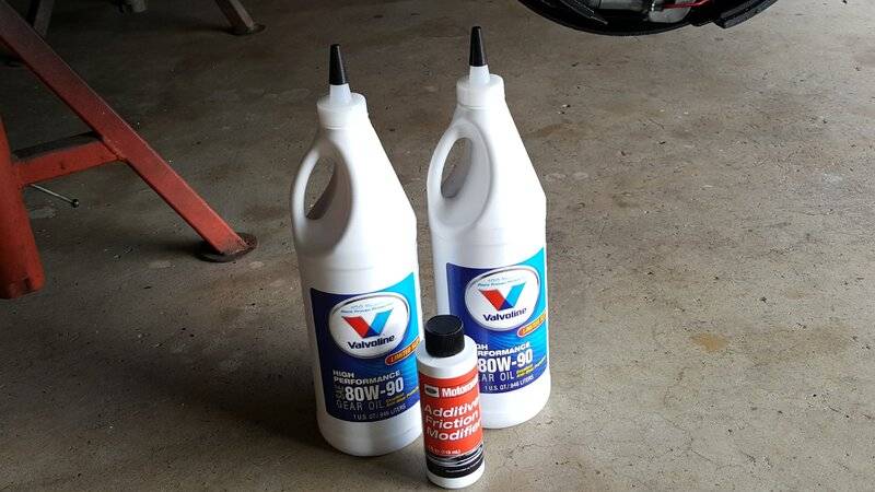

Being I am new on this forum I am sure this was ask before. My friend has a 66 Bel. and had the rear rebuilt with 323 posi. What oil and lubricant do you guys use in yours? Thanks from Big Mo.
80W90 real oil and add sure grip additive.
Hey Big Mo. Welcome to the Madness if I missed your Welcome Wagon.
First off lets correct your description before you get castrated. GM has Posi units, Mopar use Sure Grips :)
Depending on your climate and it is the same as mine...
The Ford Friction Modifier is the proven additive. You can get it at your local Ford dealership. One bottle will do it.
Avoid synthetic lube in a new or rebuilt rear for 500 miles.

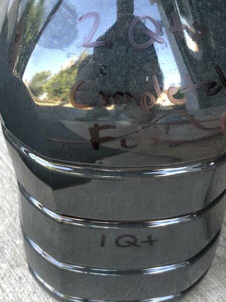

I just changed the fluid in my rear end a couple of days ago and it came out almost gray metallic.
From what I can find on internet, this is from metal wear and particles ending up in the fluid.
Should I be concerned?
