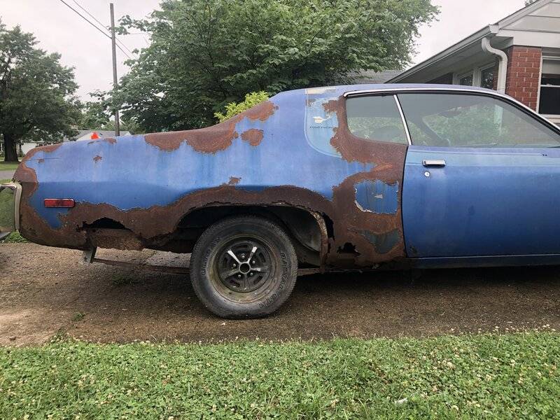

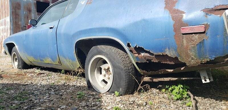

I am looking for the patch panel or how to form a panel for a 74 roadrunner. I have a panel for a 71-72 but it doesnt have the flare out the 73-74 has. Has anyone made the flare out and how did they do it.

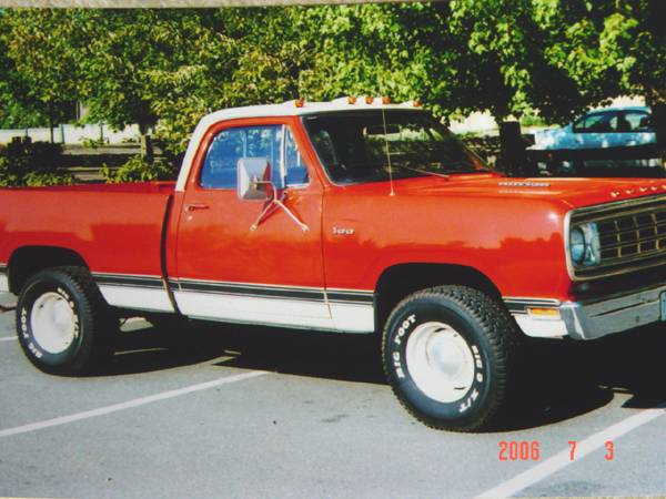

There's some speculation that 72-80 Dodge truck fenders can be used for the entire arch.
I have done some comparisons and they are VERY close (I own both vehicles), but have not actually tried it.

They repro those truck fenders and box side repair panels as well and they're relatively cheap. I bought repro fenders for my 440 shorty.
Looks doable but no one has seem to have tried it. I think I’m just going to fab them myself unless somebody has actually done it
