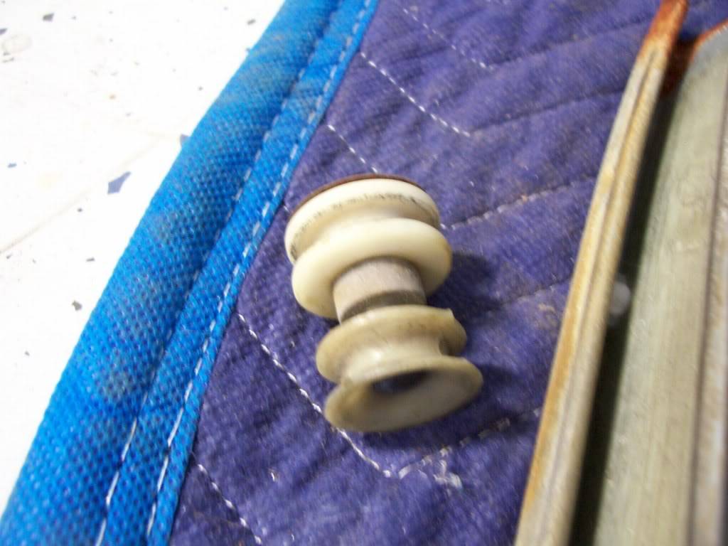

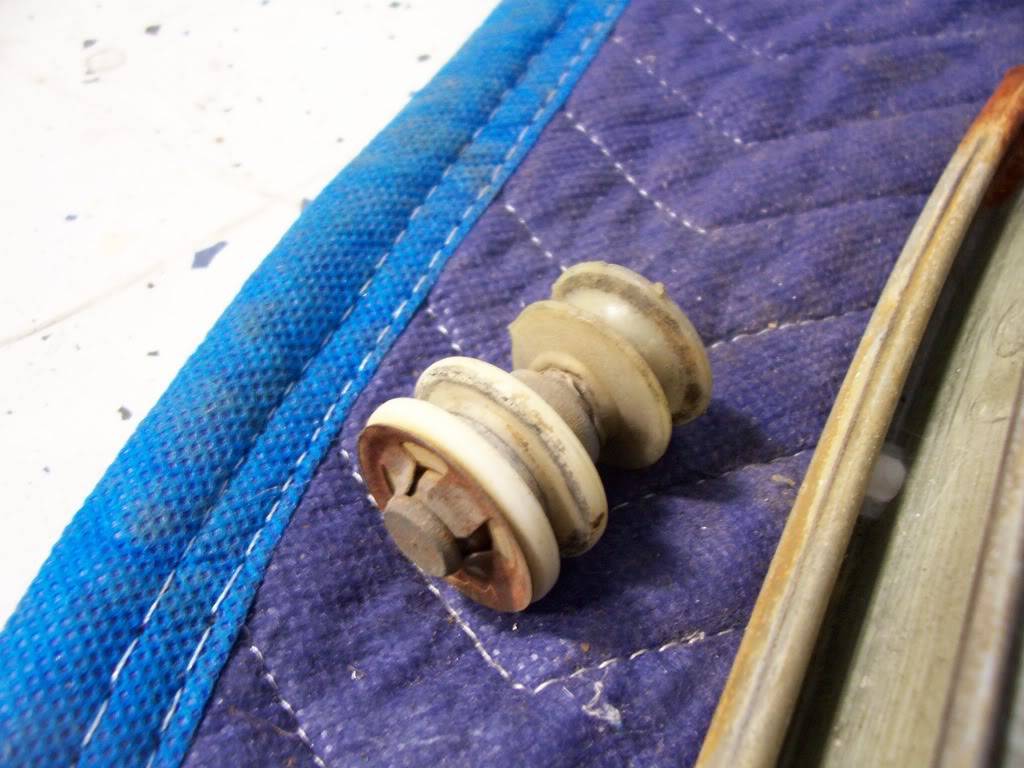

I am looking for a bushing or roller that went in the location that is circled. I have no idea what it looks like because it was missing from the car. It appears to need a roller to go in the track and a bushing or roller to go in the slot. This is needed to keep the regulator in line so it will hit the stop when the window is rolled up. The quarter panels are off the car right now so it is easy to replace these rollers and adjust the windows. Thank you for any help.

his pic looks power and mine on a 69 gtx non power look exactly the same for that back roller assembly
The car is a 70 Roadrunner and it did have manual windows. I am converting it to Nu Relics power windows. (Very nice BTW) When we pulled it apart we didn't see anything there. It looks like there should be something there. It should hold the frame tight against the track so it will hit the stop. The roller that Domino posted looks like what should go there. I do have a factory shop manual, but is doesn't give a lot of detail on that part. It just shows an arrow with the "Roller" there. That's ok, but what does it look like??? There are about 5 different rollers in that window!! Thanks Domino for the pic. I will see if I can find something like that.

I just ordered a complete rear window kit for both sides and was done with it. Now I know that all the pieces are new and will hold up for a long time. Domino, the piece that you showed was correct. Thank you. The new power window setup from Nu Relics works amazing. I will post some pictures soon.

You're welcome. Timing is everything, just pulled the car apart and boxed it up...
It was laying out ready to be bagged and tagged.
