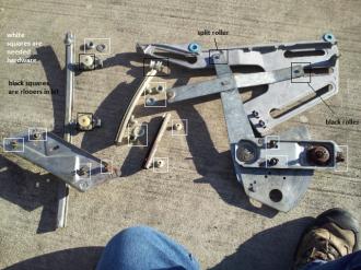

So I've just found myself in this fresh hell.
Two questions, first does this kit have the double roller pictures that was missing? I'm missing one as well.

All the kits I find look the same. Is that 'double roller' made up by combining the roller on shaft with another roller? Or is just not in that pack?

I believe it is, I'm looking at buying that kit as well and need the same double roller. Looks like the two rollers that are already mounted on studs are the ones you speak of. But I have a question myself, I need the two rollers that go on the track that runs up and down near the front of the assembly. Does the kit come with those and you just reuse the same studs?

if you look at the pic in the link, the rollers that the silver shaft is pointing at, are the ones that slide on and you use one of the clips to hold it on. as for the the way the guts go together and hardware needed, i still have one apart on the floor. i will post some pics to help. took me 4hrs to put in my passanger side. got the car in a basket though.
here is the pic of all that is needed. i have a guy that has extra parts if needed.
