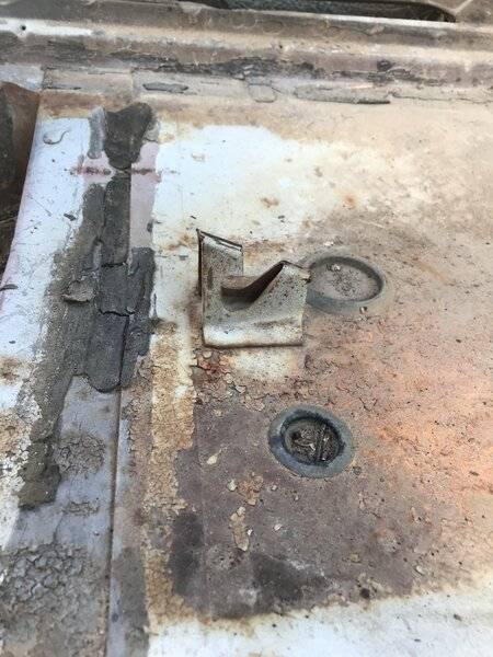

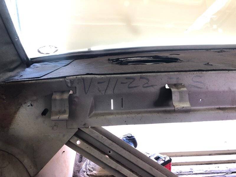

First of all, remove the window winder cranks, and armrests.
Push the front seats all the way forward.....get in the back seat floor behind one seat....knees almost into the bottom of the seat base, and slip your hands in front of your knees.
From there, push your knees into your hands, and the seat base should release enough to pop up.
If the hooks are damaged or twisted, they will need repair or adjustment before putting seat base back.
