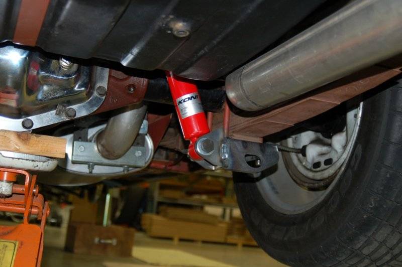

I run Koni shocks on the Coronet. I had to build my own shock plates out back. I made them double shear since I'm not a fan of the stud mount that the factory engineers used on these cars.
