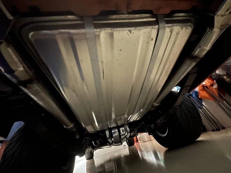

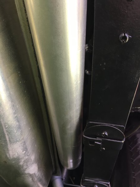

Funny you should ask ...
Not sure about the first photo but the springs are definately moved in in the second photo
