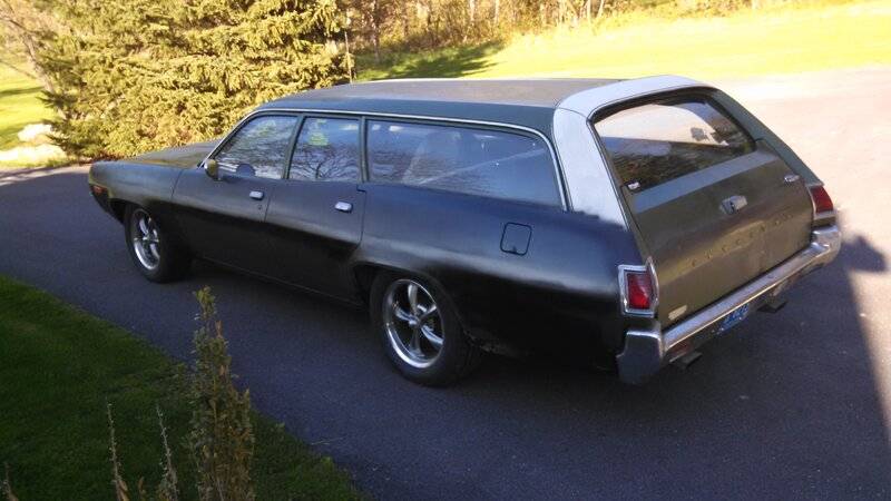

My son saw it here at Christmas three years ago https://barnfinds.com/outerspacious-1972-plymouth-satellite-wagon/ On his way back to Houston from here, he swung by and decided to buy it. I forget what he paid but it was 3k plus as I recall.
It had the 150 hp 318/904 in it and actually ran pretty good after a little tweaking. Was not the best thing for merging onto the freeway or pulling out of a parking lot onto the feeder, tho.The rust is not too bad but it definitely needs some holes fixed and some dents pulled out.

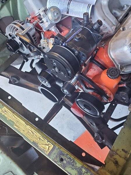

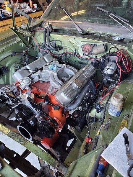

I had a 440/727 sitting in the shop that I had pulled out of my Challenger a few years back and I told him it would be an easy swap. I should know better than that at 79 years old, but, hope springs eternal. I used all the brackets on my stroker so we soon found out that trying to buy a matching pulley set was expensive! It turned out to be cheaper to go with the CVFRacing set as shown in the picture. Pretty sure we could have built a fresh 360 for what all the replacement things cost but we probably would have upgraded it as well...
I just walked out to the shop and took 3 pics to go with the link above.

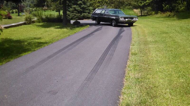

I've been running the Mopar SS/D super stock springs under my '72 wagon, for about 20 years. Back in the day, it was a high-12-second street car with a MP 360/380 crate motor and a reverse-manual 727, and on street tires it pulled consistent 1.60 60' times. Also drives great on the street and has made countless trips from Maryland to Key West, FL. Those springs, and a set of old-school Monroe air shocks, were all that was needed to make it an awesome daily driver, and weekend track toy. The springs transfer power well, and the air shocks would compensate for floor-to-roof luggage packs with no problem.

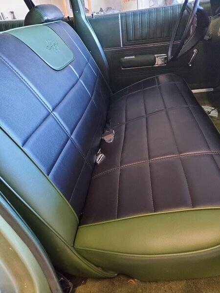

I wish I still had my front bench seat....but its long-gone. I have to figure a way to get my '05 Magnum front buckets to fit the B-body floor...

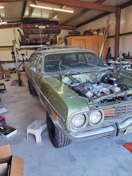

Thanks for the GN compliment. I have two-one I bought new back in '86. The one on the rack is one I built for my son when he was in high school back around 1999. He is here for a couple of days and we finished up the pulley
install.
