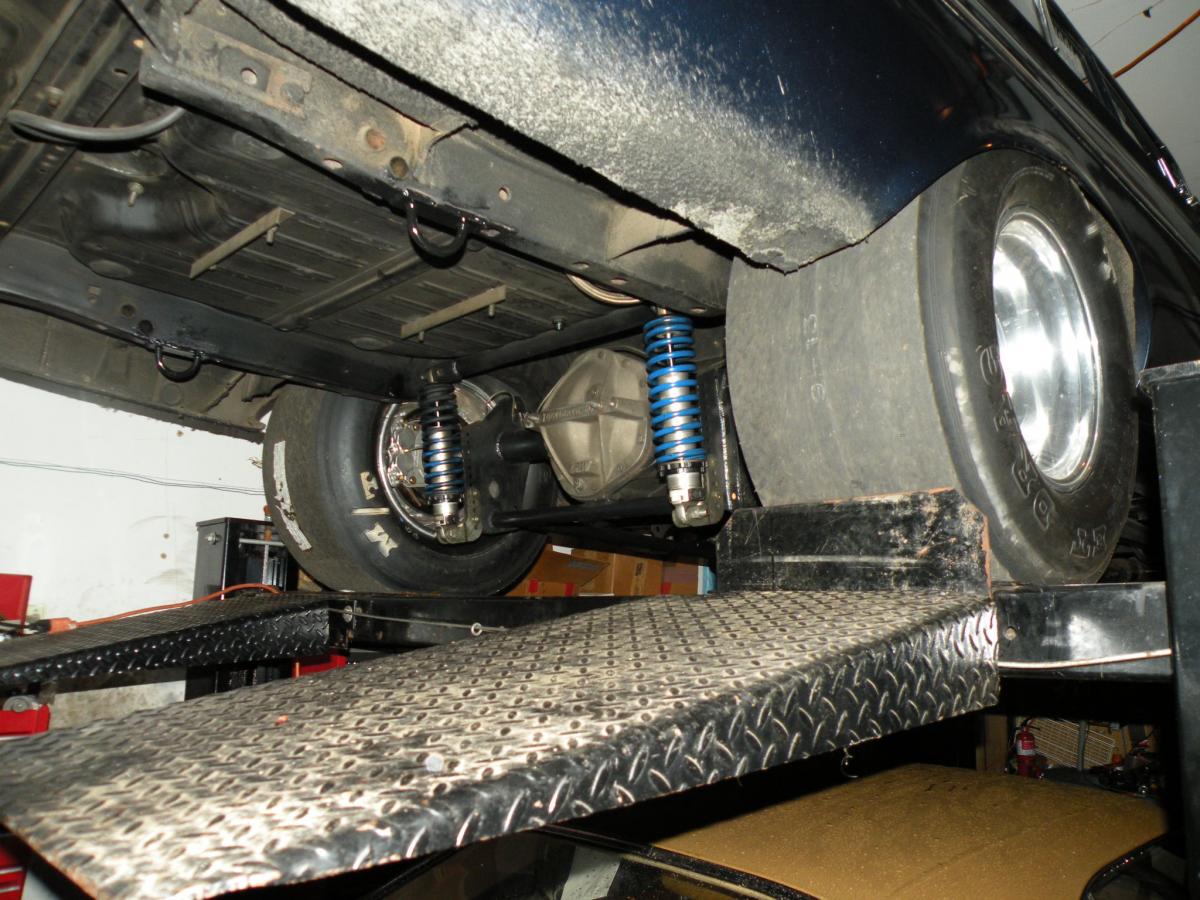

The biggest problem for any stock frame rail mopar is the length of the rear shocks to get proper ride height.Its not a major problem,but something that needs to be measured and thought out before ordering a shock with a ride height of 14" or so.
this is the smartest thing in this post. i had my 1st ladder bar car done by a nonmopar chassis shop and he put the wrong rear strange double adjustables in and cut my trunk floor and had to add a cover so you dont see the top of the shocks. i was pissed. the shocks were way too long.
my next 3 cars were done by a mopar guy and used the shorter correct strange coil overs and it came out correct.

this is how it should be done. shorter shocks with upper shock holding tube under trunk floor. this car hooks in the snow!lol

Those look like 12 to 13" ride height shocks wich is pretty the standard for mopars.Hey SSR,I see you have moved your IC down a few holes.The top holes a little violent on the launch or the rear bumpers are to expensive to be draggin.:headbang:
good eye on the ic move. it was doing crazy wheelstands in the top hole.
bringing the bar down did help a little. not much. this car makes insane torque.
almost torque as hp in old combo for some reason.
got a new engine combo so we will see what happens now.

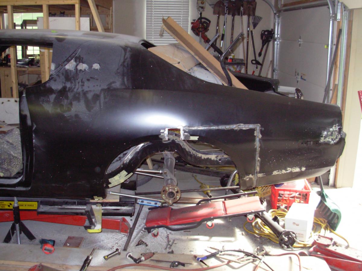

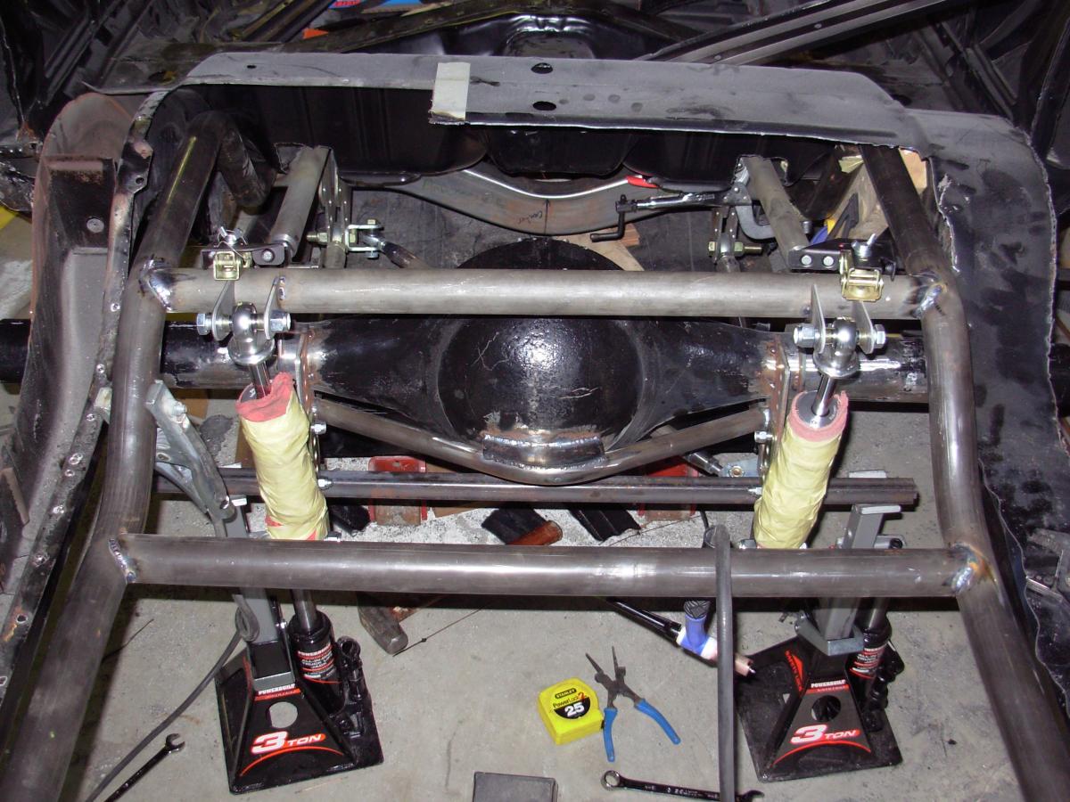

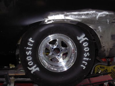

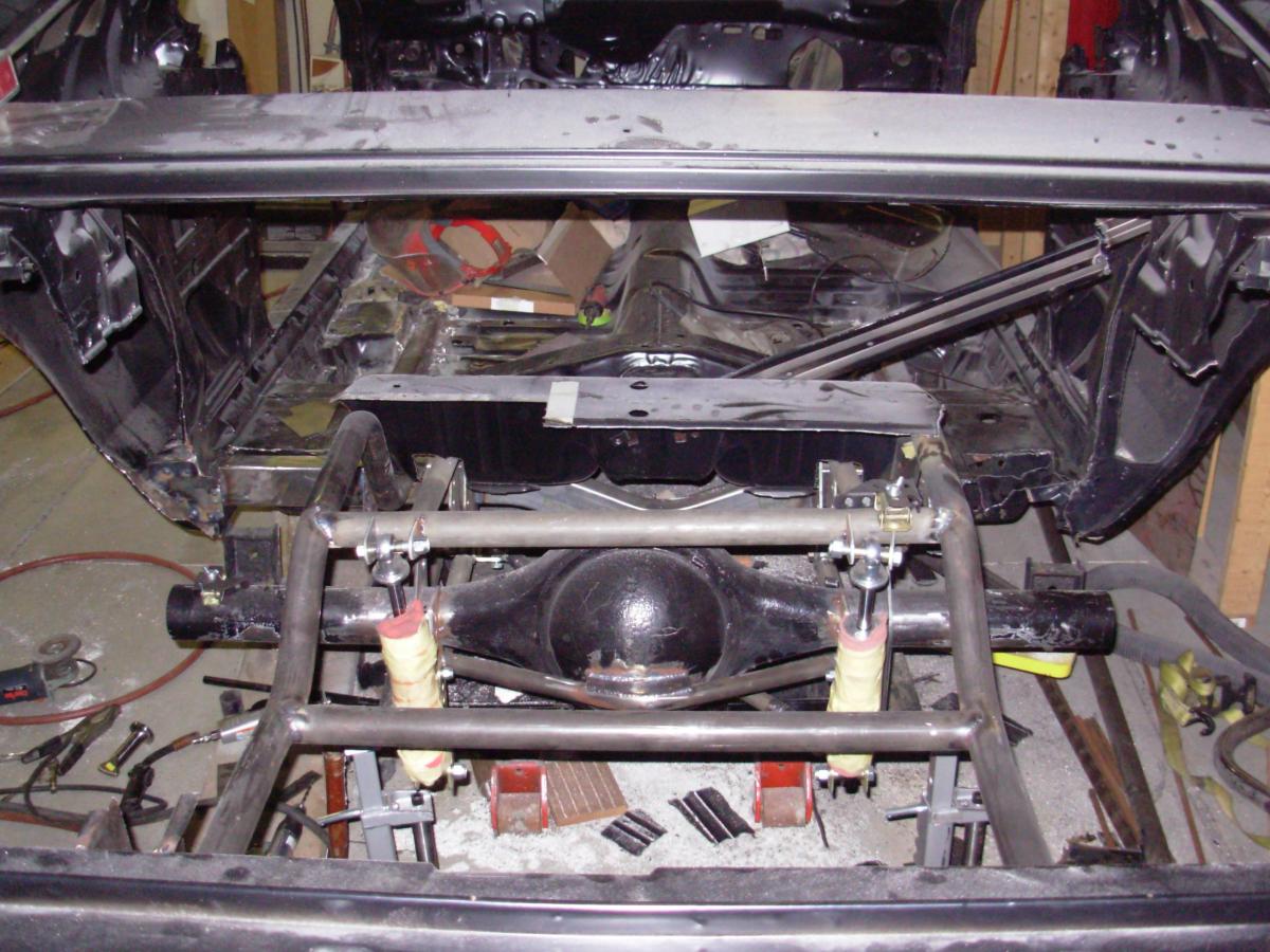

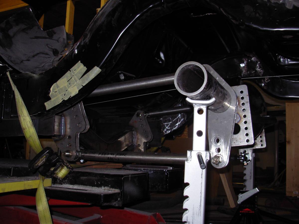

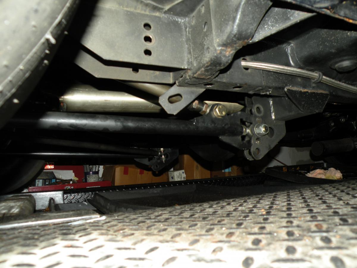

Here is some food for thought.
The first picture is what I setup and speced out with a 29.5x10.5w series tire.Heres where things get really screwed up.I let the owner order the parts and make decisions.As you can see you can put a four link under the factory floors,but are limited to tire size and adjustment.
The rest of the photos are a rework at the owners expense because he new best.Wheel openings are only 34"and area between rail and qrt is 17.5".So he ordered a 32x13.5 tire because he felt the 29.5 didn't fill the wells enough.A 32x13.5 actually measures 34" tall and a section width of 17.7":angry1:
So we stretched the qrts and moved the axle back to fit the tires.Just to create another problem.The shock crossmember is to low to get the correct ride height:angryfire: So the end result is a complete moly backhalf.All this do to one easily made mistake.I'm sure most of you guys can figure out the adds in cost.Once the car is finished it will be a bad M/F.I have to finish narrowing the rear axle and finalize everything on the rear.Then the next step is a 25.5 spec cage.The owner doesn't ask to many questions any more.Just writes checks now.:icon_cheers:

That Charger looks like it will be cool ride when it's done, it's nice to have a big check book backing things up, got to love the customers buying or ordering stuff & changing their mind mid stream is also fun to deal with... Happy Moparing
MOPARPOOR. you do very nice work. Your an asset to FBBO as well as Budnicks. You two really help this site out. Its nice to have knowledgeable member on here. thanks for sharing. :thumbsup::notworthy:
Thanks for the compliment.I just hate to see people get roped into something that can be avoided.The amount of hours I have in just the rework is rediculous,due to one simple mistake.Information is everything,Ihope this helps someone from making similar mistakes.

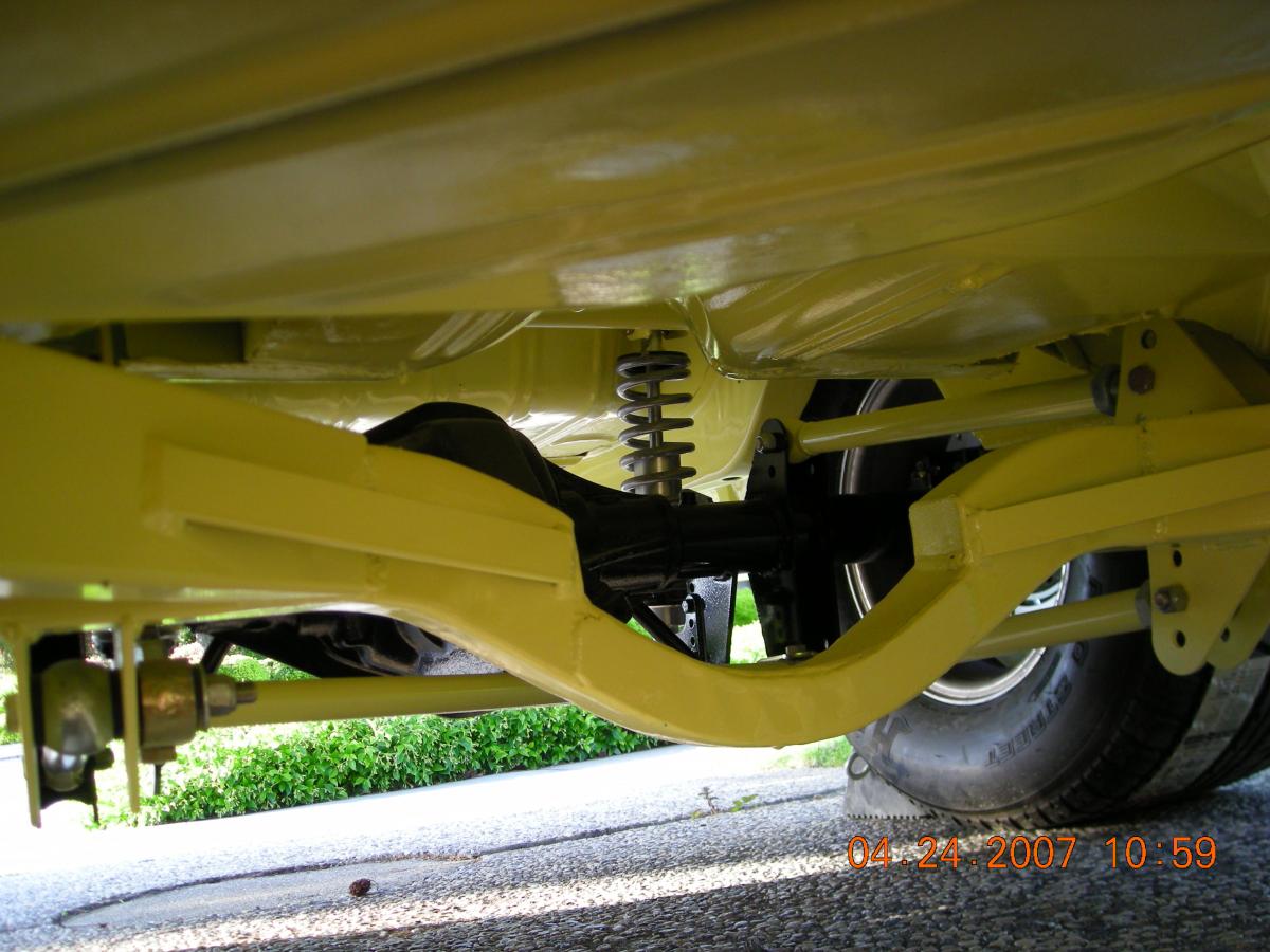

64 Sport Fury

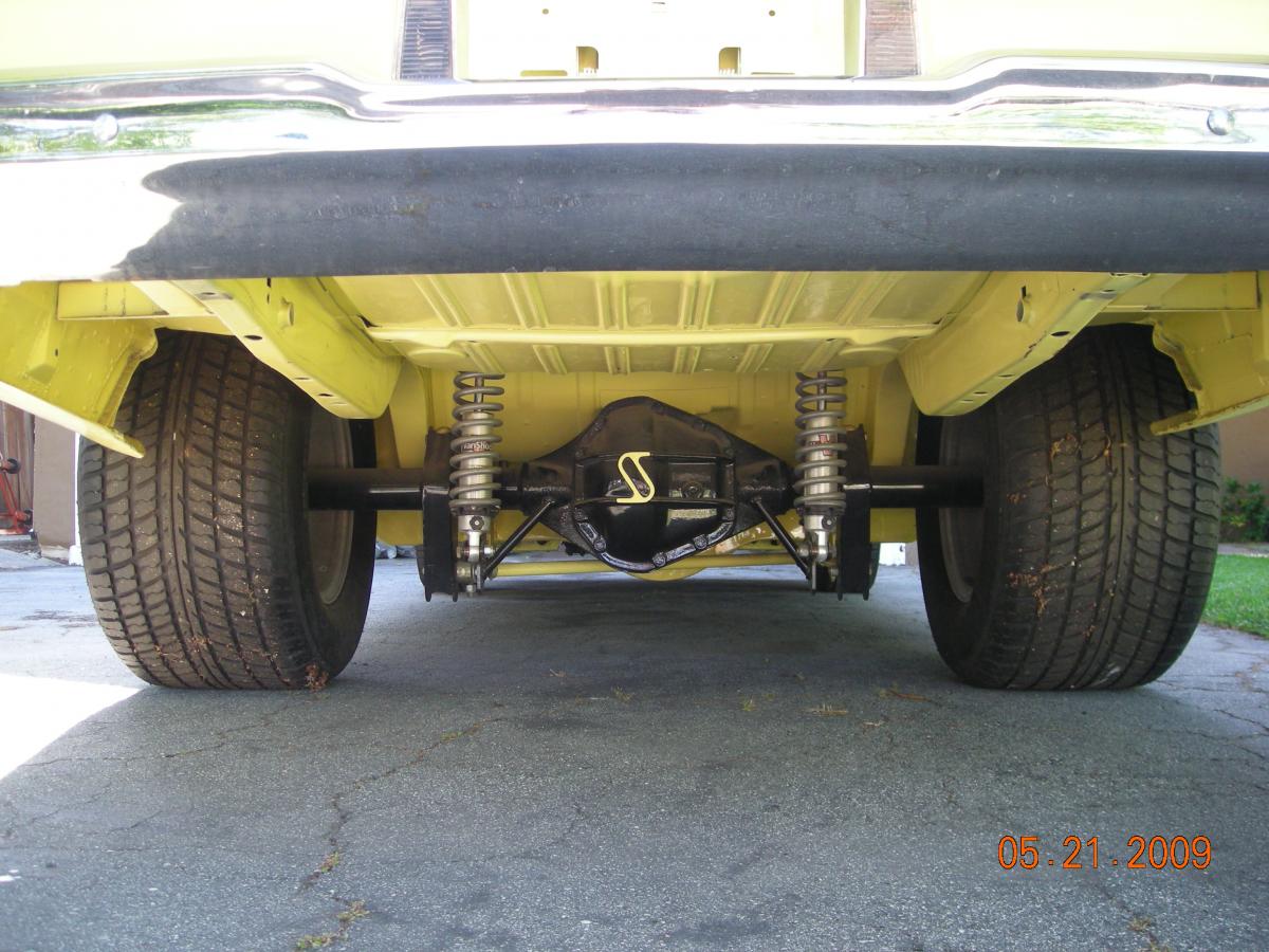

I thought about this one for a LONG while. I ordered a Dana From Strange and went with the 4-link from Alston Chassis Works.. Hope this helps..
Moose
Moose
That is exactly what is in the car.Made some mods I wanted to do,but almost exactly the same.Actually I used there brackets.
