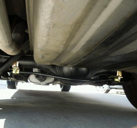

i dont know how different they are on a 72 but here is my 70
I don't have any pics but the 72 bar is straighter and runs below the center section of the rearend in front of the housing.

Scroll down??? Looks like both styles were shown.
yeap, both are there. Of course I got focused in 73/74 since I was building mine, but I show both assemblies and differences
I told you guys he knows his stuff!!
Mine still has the factory bar installed "unmolested", if you still need more.
Check with Firm Feel too. They sell a rear sway bar that is frame hung, meaning, they don't sit down low, but instead snake up and around over the axle like the factory bars. I installed one on my '68 b body and it worked out real nice. I didn't get a photo, but Firm Feel has some nice photos in the install instructions on their website I think...
