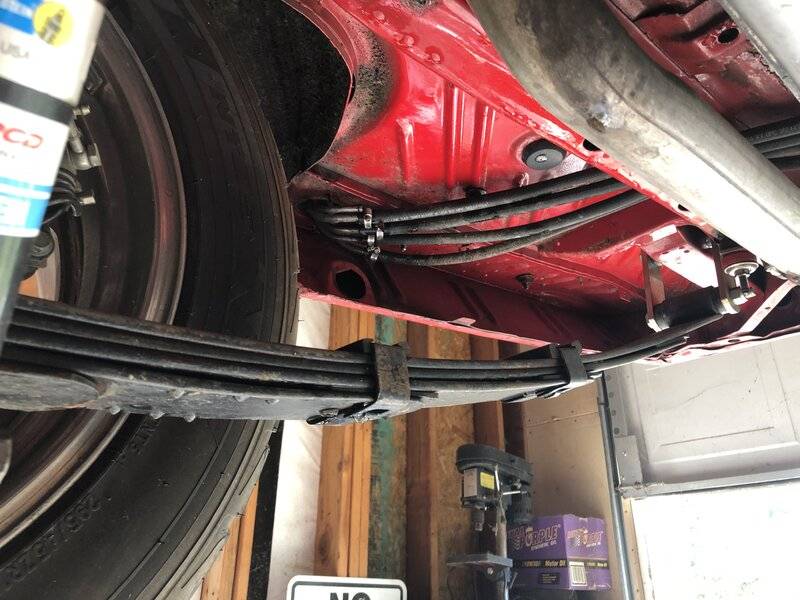

Look at how many flat leaf spring sections are in each side. Most have at least 4.

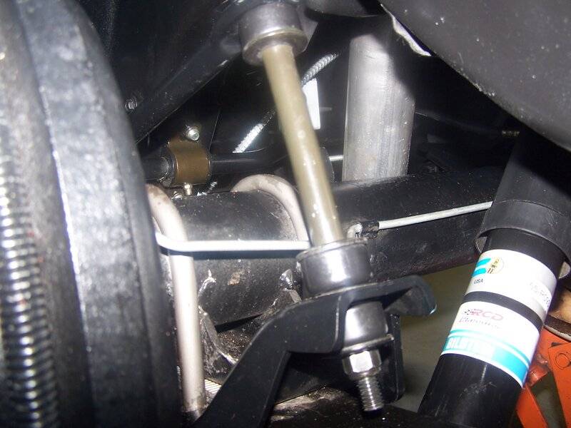

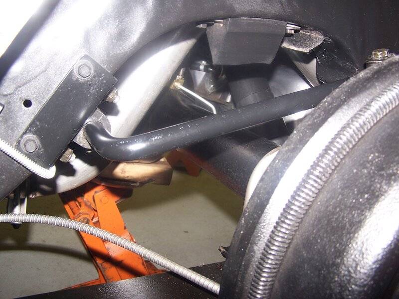

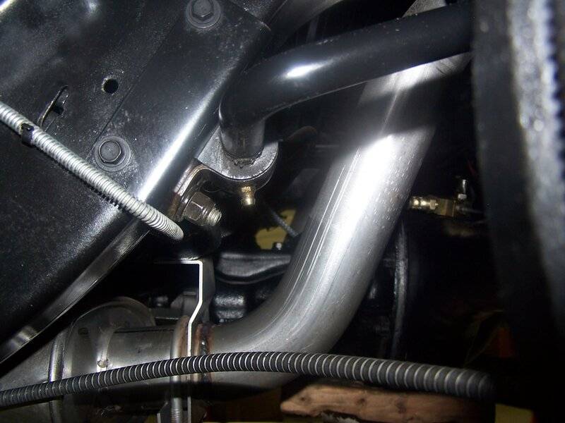

I too used the Firm Feel rear bar on my 68 Charger because of the factory style mounting. Never liked the under axle mounting adding to the unsprung weight or the looks of it. I have the stock front bar and I love the upgrade in handling. My brake line was not in the way and I installed it before the exhaust was done so not sure if it would be a problem. Here are a couple pics.
