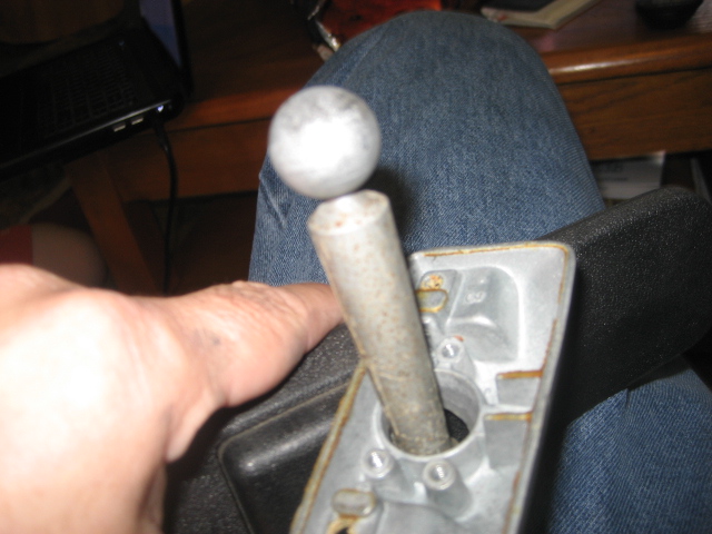

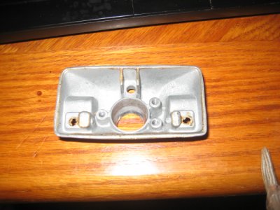

My 72's mirror is loose front screw is tight. Every time I hit a bump, mirror moves at the ball... Solution ? image.jpg

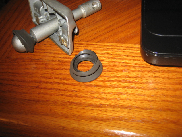

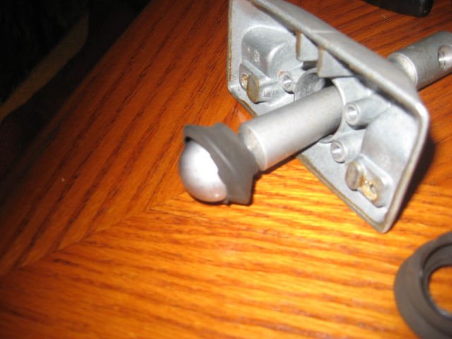

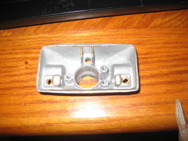

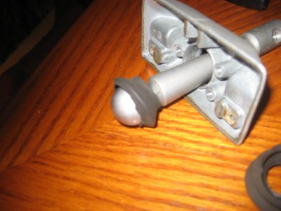

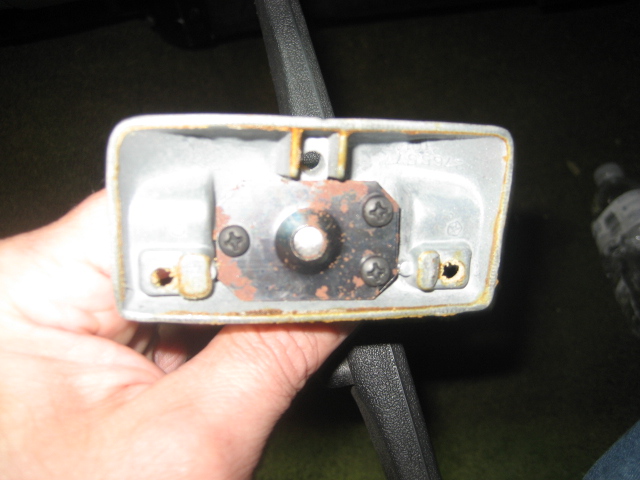

You need to take the base down and tighten the the retainer plate that holds the ball of the post in the socket of the base.
At work thinking Mopar....Thanks 2 all
Done...5 minute fix...Thanks to all...

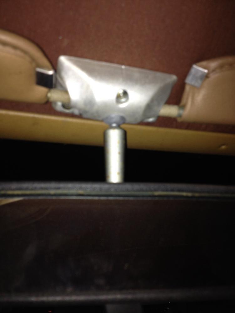

I drilled a hole in a mirror from a windshield mount and used a long screw to mount it together...it wasn't my proudest fix but it had been stripped in side an wouldn't tighten up on 2 screws and had a hideous PO fix .... I will get a new one at some point....
