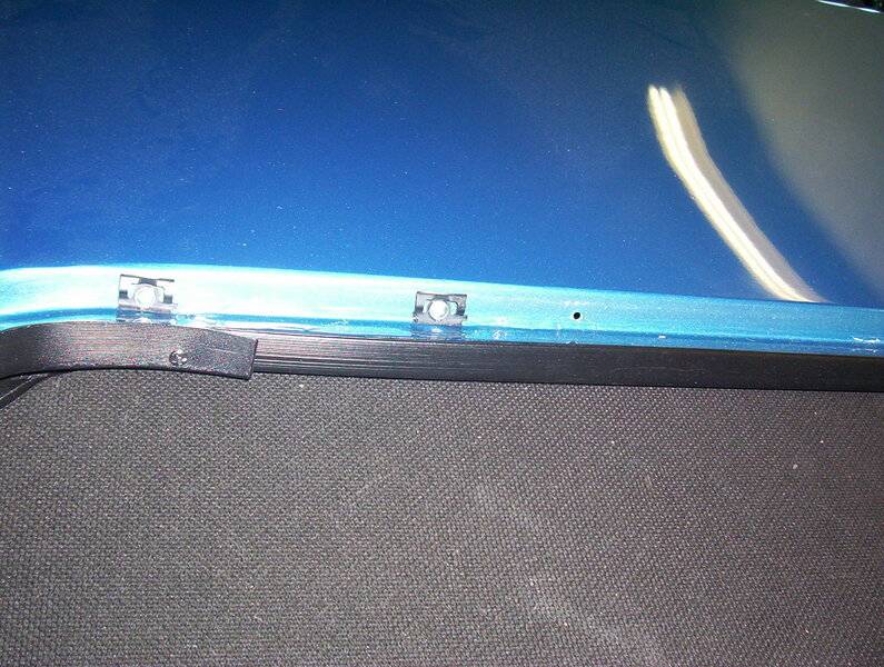

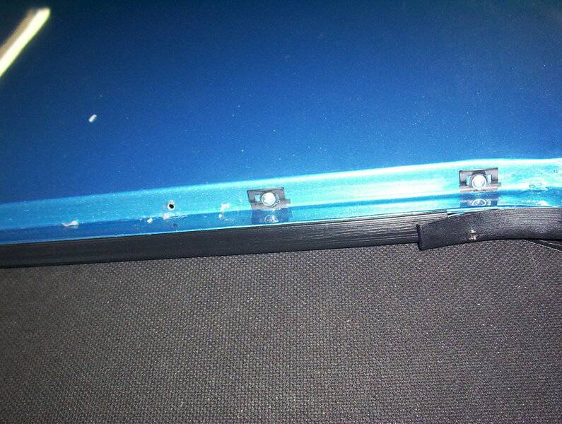

I am getting close to installing my rear window on my 69 Charger. From what I remember 5/16 butyl rubber seal should work best. On the lower trim clip areas I have the correct holes. There is an additional hole on each side. Were the lower stop blocks for setting the glass fastened in these holes. Where can I get those blocks. It has been many years since I took this apart.

I recently bought a roll of butyl for my rear window. The roll i bought, came with 4 blocks.
I am showing my lower window area. I believe I have all the clips in the right places. I have an extra hole on each side. Not sure why but am guessing did the lower window rubber stop blocks have pins that went into these holes?
