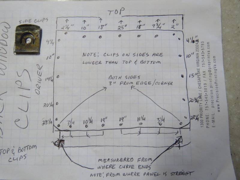

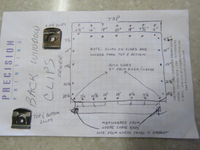

When taking the car apart, I noticed there are two different sizes of rear window trim clips -- the smaller one for the top and bottom -- larger one for the sides. The picture shows the correct reproduction (smaller clip) for the top and bottom and an original that went on the sides. I can't seem to find any vendors who sell the larger side clips. Any suggestions?

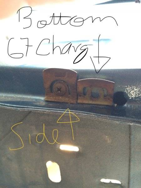

Charger rear window bottom clips were virtually impossible to find. We ended up with scavenged ones from a parts car. Sides were easy to find, similar to other b bodies. Where did you find the bottom ones?
My issue is exactly opposite of what you're describing. I can find plenty of the top and bottom clips -- can't find the side clips. The side clips are the larger type.

The large clip (for sides) is 7/8" long x 3/4" wide. The center of the hold is just a hair over 3/8" from the bottom of the clip. The smaller clip (for top & bottom), which they make reproductions of, is 13/16" long x 3/4" wide.

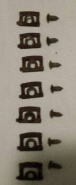

Came across these a few days ago if anyone needs them
