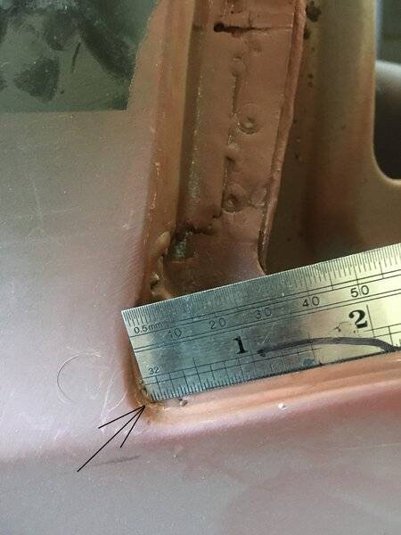

So here's the deal...
Starting at the corner (see photo) on either side and then to the next hole:

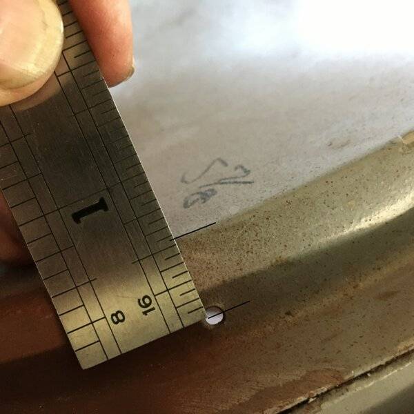

1st hole 5-7/8"
to 2nd 4-3/4"
to 3rd 8-3/4"
to 4th 8-3/4"

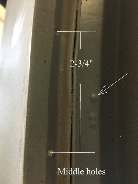

measure the same on the other side and the two middle holes should be 2-3/4" apart (see photo)
All the holes are a tad over 1/2" down from the lip (see photo)
Going up the sides the only hole I have is 18-7/8" up from the corner BUT my quarters were replaced to maybe there is a lower hole that I need to drill. If you have those holes Id appreciate the measurements.
