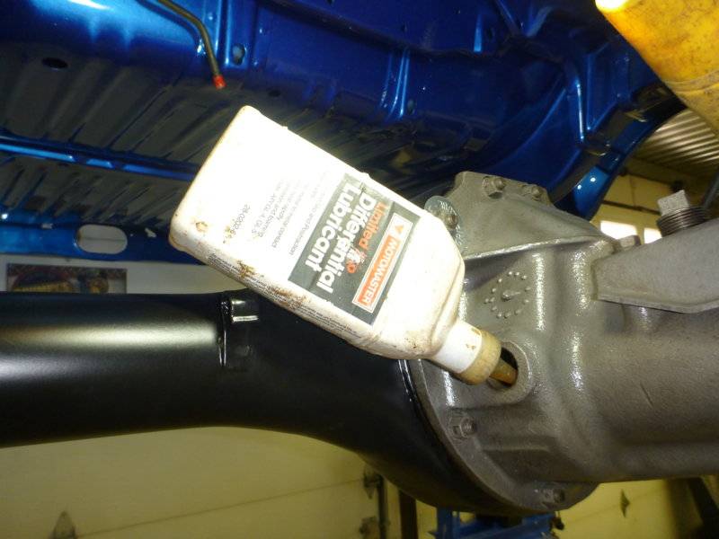

Wish I'd bought a few cases in 1979.. LOL.. but I had enough to do the Bee one last time!
