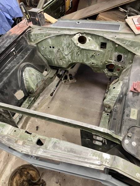

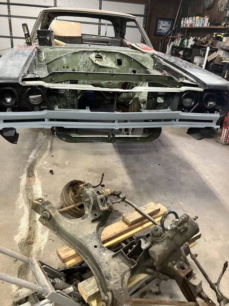

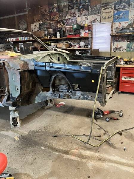

Weld in is best. You could bolt them into position, then weld once in place. Make sure the car is supported correctly beforehand though. Tires/wheels on cribbing, elevated high enough for work clearance or car on a 4 post lift. This way the car is loaded like normal and you can open/close doors without issues. If it's an empty shell, a two post will work. Some of the weld in versions will require you to take the interior out also. Like the USCT versions or the diy rectangle tube version like I and many others have done.
