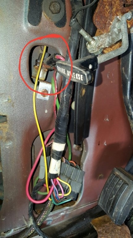

After chasing several electric problems on my 67 charger I removed the dash harness so that I can find and repair all the problems with the connections wires and components at one time. Does anyone have a good source for the fuse block, circuit breakers, relays, and connectors?
I also found a 12g light green wire that is part of the body harness attached to the circuit breaker however I can't find it on the schematic does any one know what it is for?

I also found a 12g light green wire that is part of the body harness attached to the circuit breaker however I can't find it on the schematic does any one know what it is for?View attachment 388254
