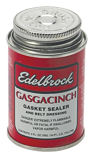

This has worked like a charm for me. Get new gaskets - I use cork - don't want ANY oil on them.
Use a bead of this "Edelbrock 1077 sealant -
" between the gasket and the absolutely clean valve cover. Leave the cork to head rail surface clean with no sealer. Gently bolt the cover down to an absolutely clean head rail (NO OIL surface!). Tighten snug but not as hard as you would if they were going on for good. Leave it overnight.
Unbolt the cover from the head and apply this product "Gaskacinch
" to the gasket, then bolt down permanent.
Gaskacinch will seal the cover to the head, but is made to easily remove. In fact, I use this set-up on an engine with mechanical lifters, so valve covers are on and off. The gaskacinch will set up like soft rubber, and if I'm careful, I can almost get the stuff off the cover gasket in a single string. The cork gasket stays stuck to the cover with the permanent RTV. When I'm ready to put them back on, I carefully clean the cork surface of the old gaskacinch and oil, then lay on another coat of gaskacinch and it's good. Can't emphasis enough how important it is to have a completely oil free surface to make this method work well.
