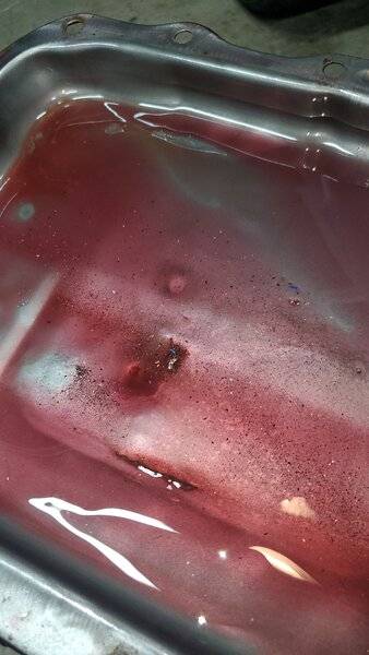

I dropped the pan of the tranny last night and found a lot of metal flakes in the bottom of it, could the bands being tight cause this much? I probably have less that 5 miles on this transmission from just messing around trying to get it in first gear.

First what your seeing in the pan doesn't bother me much. Could be from the lines, cooler, or even left over in the trans. Not knowing the timing sends a red flag for sure. It could start and run fine at 10 retarded. The real issue I see is more than likely this; less than 8-1 compression, 240@.050 cam, single plane intake, mechanical carb, 1800 converter and 2.76? gear. There is your answer right there. That combination is severely mismatched. Timing, rear gear, converter will help. But if its got the stock compression height pistons you'll be lucky to be 8-1. This combo needs more than that to be effective. I've been down this trail before. 8-1 360, .509 hydraulic, 650 mechanical carb. At least mine had a LD 340 dual plane and a 4 speed. I can sum mine up in one word, DOG.

Those dark pieces in the pan look like clutch disc friction material and the shiny pieces could be plate material. A rebuilt tranny and a new torque should be clean but the cooler and cooler lines should have been flushed out. Bands don’t typically flake apart .. they burn and wear but finer than actual flakes. I would be concerned. Large shiny piece.. is that metal?

I did find some particles that were larger than usual and actually look like metal fragment. Sadly the car still feels the same after i adjusted my bands (front and rear). I would hope it is just a dog at this point but I just have a bad feeling about the tranny.
Yeah I was expecting the same thing too, I wouldn't expect a rebuilt tranny to be having this much material released to the bottom of the pan. And yeah there was one piece of metal in the pan that I found and another piece about the size of my fingernail when I was fishing through my trans fluid with a magnet. Pretty disappointed with the transmission at this point.
