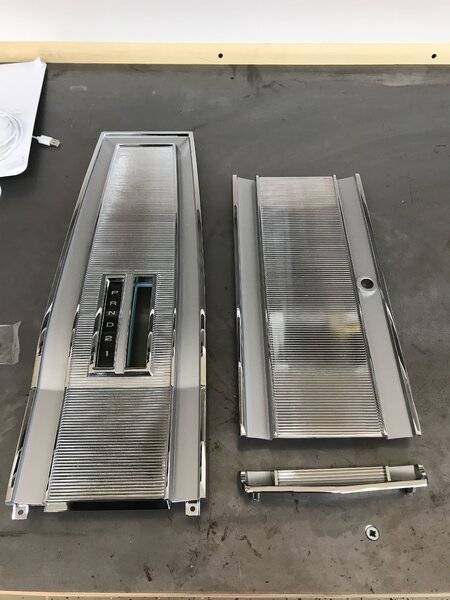

Has anyone had their 66-68 style console plates rechromed, and if so, who would you suggest? I was trying to find out if it was feasible to send them out, or spend the $650 for a new set.

Make sure your sitting down when you look at the quote.... Twenty years ago I got a quote of $1100.... And was warned up from that the detail lines may have some bubbles....

I’ve seen rechromed and they all look horrible. The smallest of Pitts on the ribs ends up huge voids. And all the sharp details are rounded off and the entire thing looks like a jr high shop project gone wrong.

Hey Steve, Paul's does Very nice work but very expensive. Any pitting and it goes through the roof. Personally the BE & A ones are very nice and from what I heard the Automatic ones actually fit. The 4 speed ones had serious issues with fitment.

You were right Brett, got a quote of $1100 for just the shifter plate and glove box door. Looks like I'll be goin with the repros.

The reason is the part will look as it did as original verses ground down and a rounded version of what the part use to look like. Keep in mind LOTS of parts are not reproduced therefore drilling and filling pits is very time consuming...
