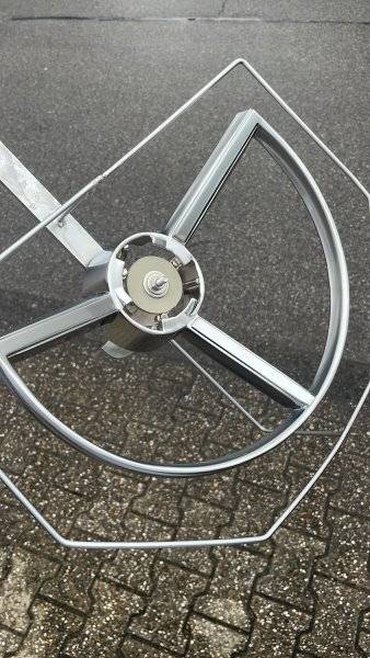

Hi fbbo,
Just wanted to share my most intense re chrome project. I did everything by myself from beginning to strip it, grind and polish it and copper, nickel, chrome plating it. I tried to hit the factory satin finish and did quite well (I think).
I never saw anybody posting about rechrome this part, so I do. There are many hours in grinding sessions done.
I would guess like 20h overall (I have no special tools). Most is done with a peace of sandpaper and my hands.
It is hard to take pictures. Maybe I will add pictures in comments when you are interested. But I need to wait for better weather here in Germany. Sun is not smiling yet.
Please tell me what you think.
Thanks
Yannik
Looks great in the picture. After the prepping the part, what's involved in plating it at home?

Lots of dodgy chemicals that the EPA don't want you playing with.

I prep it at home and plated it in the shop. I am electro plater. You can not keep these chemicals at home. The requirements here are much harder than in the US. Especially for the chrome tank.

If you guys use Instagram, you can check my highlight story about the horn ring. There are a few pictures of it, and I started taking pictures back in summer 2022. Now you could imagine how long this thing took and how much work gone into it.
Here is the Instagram story link: Login • Instagram (the story name is „steering wheel“)
