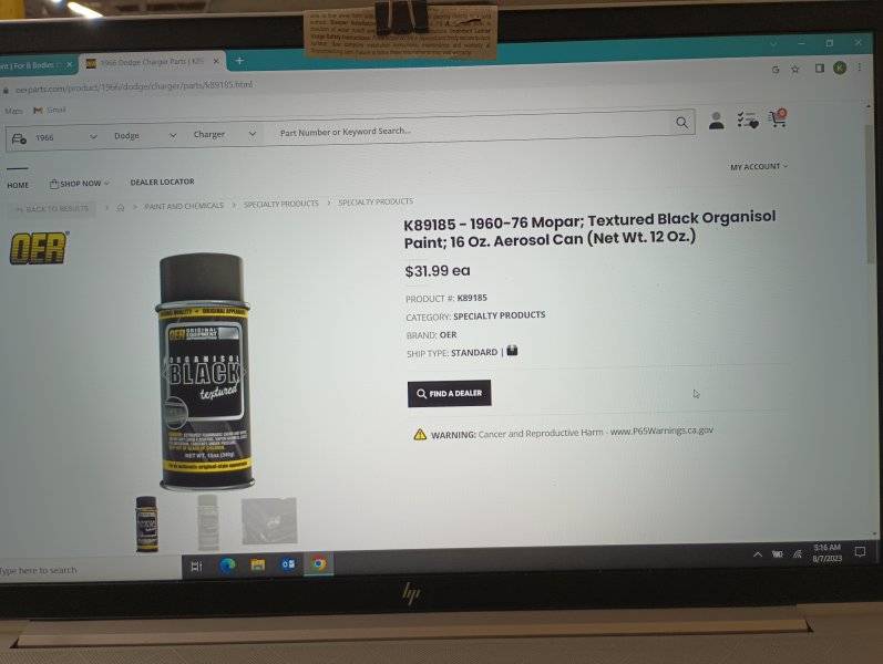

for that year it is a textured paint i'm guessing ?? OER has a dash paint that is supposed to be the same .
and i was corrected . this is the exterior paint sorry for the misinformation .
The textured organisol was used on exterior items like hood stripes & scoops. This is not the correct interior paint. It may work but is not technically correct.
8774paint1 call and talk to him he will have what you need
Ditzler/PPG called it "suede" finish paint. I bought some years ago, for my `cuda ragtop. It was about 80 bucks a pint, 15 years ago. Lacquer.
