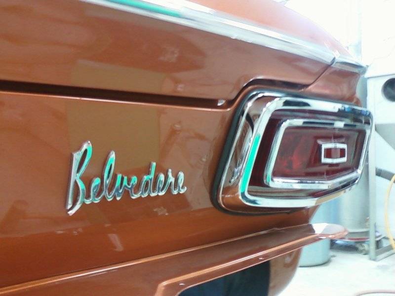

Pitted pot metal can be expensive. It gets dipped to remove corosion. All those pits are now craters or holes. It must be coppper plated. Then solder is used to fill and is then metal finished. Then copper plated. This is where it gets tricky. You have to be careful to maintain the original contours and shape. It takes tallent which costs. When it's hopefully good enough for your expectations, it gets plated. I had the tail light bezels done for my 64 12 years ago. They are pretty good but not flawless. The cost was $400

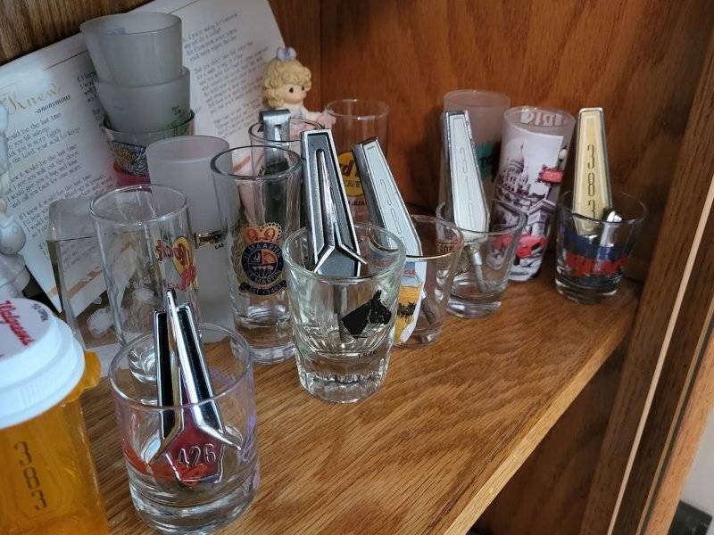

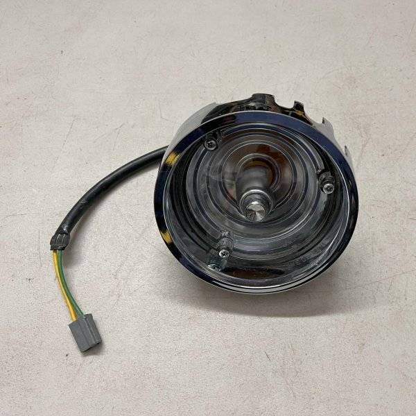

I have 2 front turn signal hsgs.
The hood ornament and it's base out right now.
$200 .
I think i should have it back in the next 30 days .

I dropped off a 2nd ornament, base and 2 front turn signal bezel assys to be rechromed about a month ago. $200 for all 4 pieces
I hope to have all 4 pieces back in the next few weeks.
