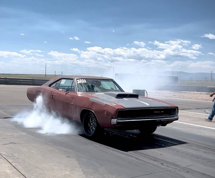

Looking for recommendations for best flowing / sounding muffler for a 383 B-Body with 2.5” full exhaust? I don’t care for the stock motor open header sound and have to have the ability to tune at home (neighbors ) so full exhaust is going back on my Charger.
I hear good things about Dynomax? Flowmaster too. I threw my Summit exhaust kit back on but figured I’d upgrade the 2-chamber mufflers it comes with. Any good resources to listen/view outside of the manufacture site and YouTube? I’m seeking the classic muscle car sound with some bite when wide open during racing.
Thanks in advance. Mid-13’s with my ‘68 Charger nicknamed “Project 68.”

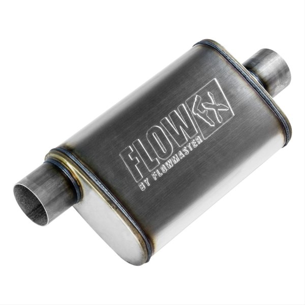

Flowmaster should be called Flowless.....
Jim Hand tested a large number of 2.5" mufflers in his Pontiac book. Compared to an open pipe, FM were below 60%. Dynomax Ultra flow was 99% & Dynomax Welded Ultra Flow was 101%.
