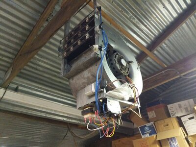

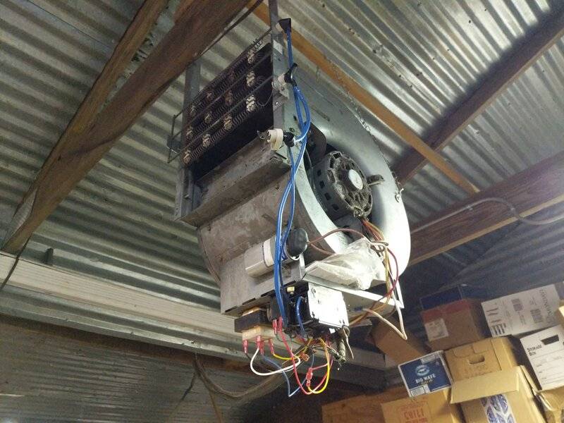

I bought a home electric heater at an auction for five bucks planning on using the squirrel cage for a fan around the shop. After some late night libations I took the squirrel cage out the electric heater elements out of the large case, simplified it with the element in front of the fan and transferred the controls to the top of the fan. How about a thermostat at the habitat for humanity repurposed store for another five bucks.

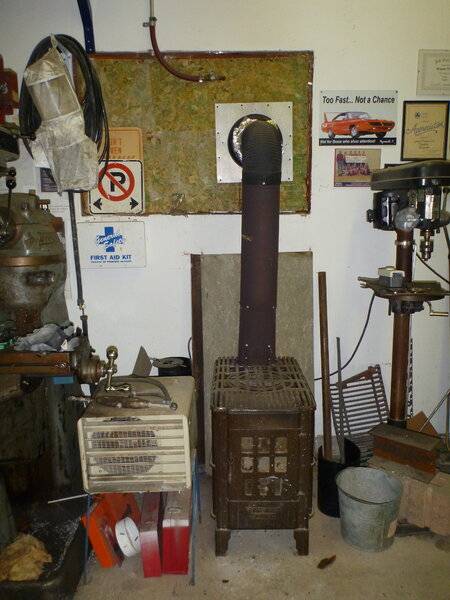

Can't believe you're worried about sparks going up a chimney and setting the forest on fire..
