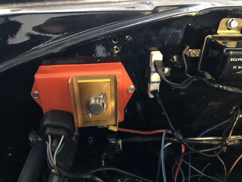

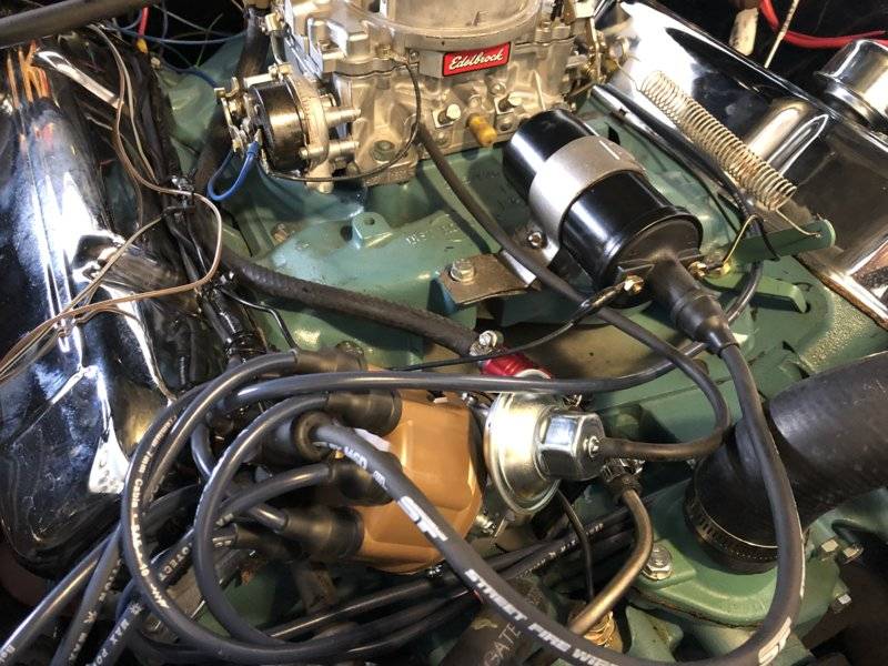

So I just installed my new Proform Distributor, and flame thrower coil. Pretty sure I followed the instructions correctly and the car tried to fire for about half a second, but now the car won’t even try and fire. I’m getting about 5.2 volts to the positive side of the coil and yes, I made sure to put the distributor in the same rotor position as the one that came out. Anyone ever installed one of these? Here are pics of what I have done thus far
D770A9D9-1DC5-40E0-A423-A0392A34EF3E.jpeg 835AFBB7-7EED-4435-A485-48F744DBA21C.jpeg
Are you sure you are not one tooth off,advance looks to be too far forward tho be timed right.

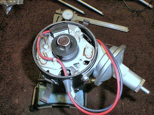

Only goes two ways on a slotted shaft. Slants and chevys and also oil drive shafts have gears. Might be another deadly orange box? New electronics suck!
Referring to the drive gear/cam orientation.Would be interesting to see where he has No. 1 on the cap and orientation of pick up compared to a Chrysler unit.
I would hope it is clocked the same way. Be really confusing for people not familiar with them if not and they are using the FSM as a guide.
Confusion is not hard to find.The first Pertronics unit before the Ignitor 11 had to have one hole elongated about .020 and you had to move the wires one position on the cap to make it work on a dual point Prestolite. Pertronics later quit listing the first unit as not applicable to the Prestolite but with a little common sense you can make it work.
