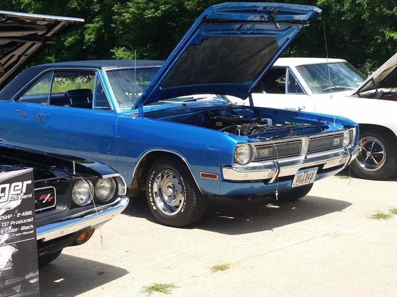

I bought the oe clips but had problems installing them. I figured the insulation was more important than being OEM correct and chipping the paint up around the holes. I went to Napa and bought some plastic Christmas tree clips (Mopar part number of course) LOL They worked great and look better than the rectangular shaped metal clips in my opinion. I did buy the molded REM pad. Nice fit.

That looks great!
