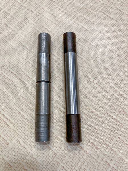

I read this thread with interest. My 440 engine came with the car although was pieced together and was a replacement. I have a fuel pump rod but have no idea if it is the original factory piece. From what I have read here, a good used factory piece is preferred over the replacements. I also have a new one from 440 Source and have compared the dimensions.
In the attached picture, the one on the left is the old one and the new one from 440 Source is on the right. The old one has a machined recess groove in the middle of the wear surface. Does that identify it as a factory piece? The dimensions are as follows: Old - 4.334" dia. and 3.220" long. New - 4.333" dia and 3.237" long.
The old one appears to be in good condition and the wear surfaces are highly polished (not galled) and with very little accumulated wear. Is the old one factory? Should I use the old one?

I would run the old one and never think about it again, if you use the new one i would strongly suggest taking it out and checking it after a couple thousand miles. I believe they measure 3.225 from the factory.

I agree with Dan64. That original rod would be going in my motor.
Alrighty then! The old one is it. Did you confirm whether that groove was a factory marking? I suppose if the old rod measures 3.220", the it only wore .005" for as long as it was in there. I don't know how long that was, but had to have been a few miles. Wonder why the new one is .012" longer?

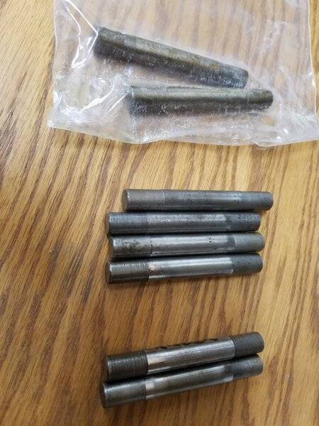

I have several original pump rods and none of them have a groove. I would imagine that they had different manufacturers back in the day though.
Interestingly, the wear pattern on your originals look very similar to mine. Highly polished at the ends. Strange that they can put a man on the moon, but cannot recreated a simple mechanical rod with the same properties as the original. I would imagine most would pay a decent amount for the high quality unit.
