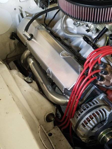

I used a cut-to-fit braided stainless line, with some of Summit's black AN fittings. Carter mech pump to Demon double-pumper style carb, looks and works good. I wanted the flexibility in routing, so I didn't use the steel hardline on this one..here's some older pics (engine's apart at the moment)

BK I don't know about pre-fabbed, since there are so many different lengths required depending on the pump/carb setup, but all it took for me was cutting the line at the desired length. The fittings go on pretty easily, and then you can fit it just how you like. I could have probably cut my primary-to-secondary line about 1" shorter but oh well...I was going for nice gradual curves.
Got this setup from summit.
Looks like Im going to need a taller carb spacer because the rear line is tight against intake manifold.
Also got a similar "build your own" setup to go from pump to carb.
How do you attach ends to hose?
