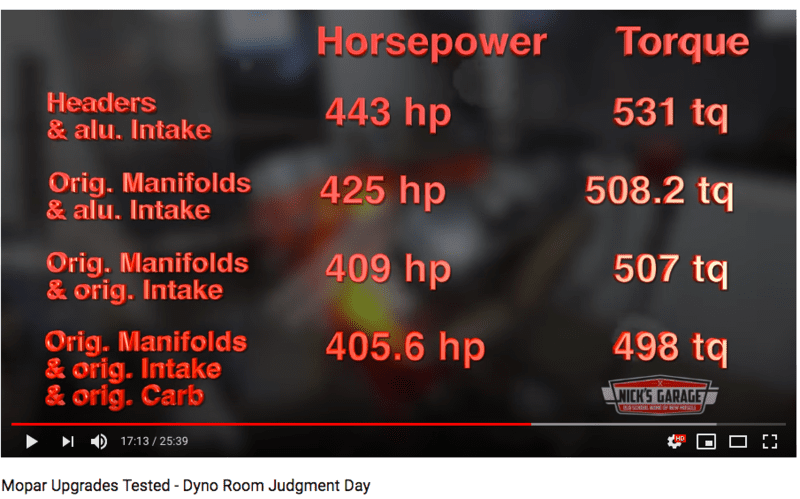

Shorties can be as pricey as some long tubes, but they are SOOOO much easier to install.So seems like everyone here says d452s are the way to go. Honestly I refuse to use hp manifolds. From what ive seen on countless dyno testes they do absolutely nothing. I may consider short tubes but it seem sthat they are just as pricey as the long tubes. Thanks for all the help guys!
