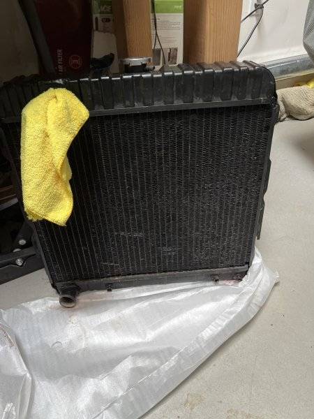

I see this being chatted up here and just wanted to throw out a couple of questions to everyone. I have a stock 383 in my 70rr that has been running quite hot. By the dash gauge it moves up quick to 200-230*,but I hear that those factory gauges can be off by 30 degrees or so. I have a 160* thermostat and when I run here in Arizona she gets very hot. The other day got back from a ride out to my buddies shop and it was about 80* outside and was 45mph moving traffic and the dash gauge went to to max.260*. When I got back the over flow tank (plastic) was boiling like a pan on the stove. Kinda scary!!
Went to pull the factory 22” out and noticed draining out the coolant that it seemed I never really got the 14.5 quarts + the engine blocks worth of coolant.
My buddy suggested that this old copper/brass factory radiator is done or plugged and to make the leap to a 2row aluminum unit and cooling problem solved. I’d like to keep a factory radiator in it cause that’s what came in it. Worked for 53 years why not another 53? The question to anyone is: Is it worth it to recore this original and maybe get it dipped and rodded or get a replacement factory or go aftermarket aluminum?

Glen Ray is in Wisconsin. Well worth the freight there and back. Quick work and good value for the money. One of the few vendors that sends you the pieces back with a bill instead of making you pay upfront. At least that was my experience.
Contact GlenRay Radiator’s.
If you want to get a new factory spec replacement there is no alternative.
He can also recore your original radiator which of course makes the most sense in your case.

When I got my 66 Charger/ w 383 back in 2010, one of the first things I did was to flush out the engine block, pulled the radiator, took it to a reputable radiator shop and had it boiled out, they re-painted parts of it as well after the boiling process. Re-installed it and and installed a FlowKooler water pump. Running a 180 thermostat, temp runs right at 180 and even on hottest days here in PA never overheats. For what it's worth, in my opinion the Flow Cooler pump makes a big difference. Good luck with it..

lay your radiator on the ground with the inlet/outlet facing up. Run scalding hot water through it with a hose until it comes out and let it sit for 20 minutes. Turn the radiator up as it normally sits and take note of how long it takes to drain out completely. It should drain very fast if it isn’t clogged up. If it drains slowly, stick the hose in again with scalding hot water and run it through the bottom to the top and top to the bottom for a good while. Maybe a half hour switching back and forth and then try the test again to see how quick it drains. If you notice good progress, keep at it, it may not need recored. I was able to solve my overheating problem just by doing this and saved a lot of money. I also back flushed the heating core as well. It was clogged too. Amazing how much dirt and debris will come out in time with hot water. I have a stock 22” radiator on a charger with a 383 and it runs at 180 all day in 90 degree dog day weather After doing this.

A modern 2 row, with 1.25" rows, aluminum from a reputable company, not ebay or Amazon, will be around $600ish. Were $300ish about 3yrs ago. You can get 2 row 1" rows for $300 still and more than capable of cooling a stock 383/440. Will cool extremely well. Then keep the original for later if you do decide to do a restoration. Then pay the big $$$ for a recore.
