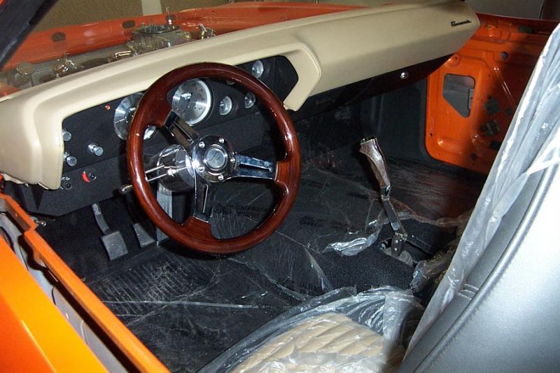

Here is a photo of the interior. We machined the lower part of the handle on a new reproduction pistol grip shifter to fit in the 6 speed transmission. We also had to machine a shifter mounting bracket out of 1/2 inch aircraft aluminum to position the shifter in it's stock location. Look close at how high the shifter sets. The only other thing that lets you know something is up, is the shifter handle now has 6 forward speed numbers instead of 4 on the pattern indicator.
We also installed a nice stereo system.

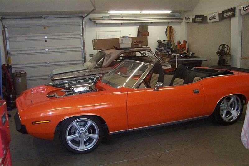

Here is one we just build and it just sold at BJ Vegas.
http://www.barrett-jackson.com/application/onlinesubmission/lotdetails.aspx?ln=684&aid=524
I was just informing him that IMPO that cut a 71RR will most likely hurt the valve and is not that easily reversed. If he is not worried about that then cut away. The only one to have to impress is yourself.
That is one bad a$$ 55 F-100, $132k must be nice... one of my favorite truck/body styles of all time...
Ya the mid-fifties Ford F100 is really popular. Have around 60K in this one. Sold for quite a bit more that expected. Was hoping for around 80-90K. It has really, really nice paint.
I think it needed to sit about 2-3" lower. To me a proper Restro-mod needs to have the rear rims up into the well.

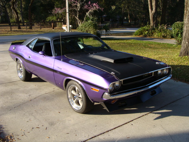

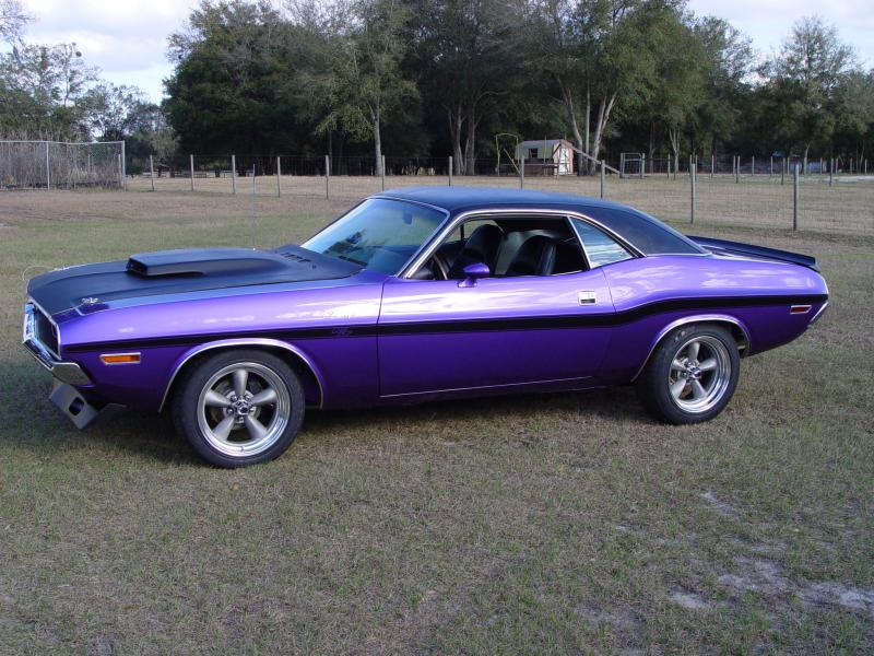

71airgrabberRR I really like what you did with your Challenger. Looks like a really fun car and love the color.
Thanks. I built this car for a very good friend of mine. It's a BLAST to drive in more way that one.................
Plus it has ice cold AC, power steering, stops on a dime with the 4 wheel willwood discs, and runs on 93 octane pump gas.
Much better than it was when it was new.
That's why I posted the photos for Lazarus. To give him inspiration as to what can be done with his car...................
I say "Get to work !!!! " LOL
The color isn't a true Plum Crazy, but a special PPG formula. I have had several other FBBO members ask for it. I now have it saved to my computer, so if your ever interested, just let me know.

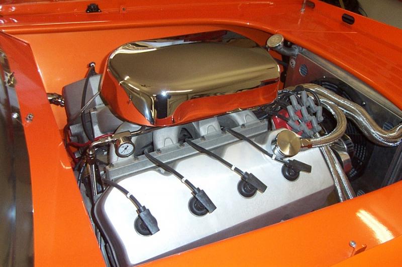

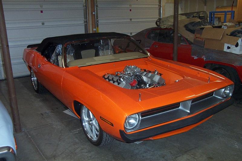

Here is a Restro-mod that cost way more that it will ever bring. I was the 3rd shop to work on it and pretty much have it finished. The 1st shop talked the owner down the wrong road and in the end had way too much money in it. About 225K. I could have saved him a good 100K if I would have started this car.
badfreakena$$ery
Awesome car moparmark. I can't afford to go that high end, but I do plan on getting close!

1971, I thought I really liked that paint color. I actually saw your pics not too long ago and you looked up the paint code for me! I am completely torn between your color and one with a little more blue in it. Very good looking out btw!
That looks as mean as it gets!! Very nice!

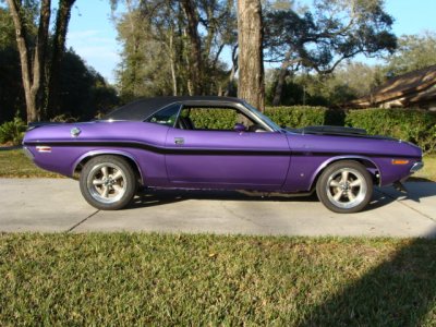

Different color in different lighting.........
Mopar marks, what makes you prefer them over power? I've never had manual disks. The manual drum need a little more pressure than I like. Is there much difference?
This color on the Challenger actually looks a lot different depending on what angle you view it from. There are not any pearls in the clear. Its all in the formula.......
Check these pictures out..... You will see what I mean. Sometimes it looks almost like the real "Plum Crazy", others it kind of looks reddish, other times more blue.

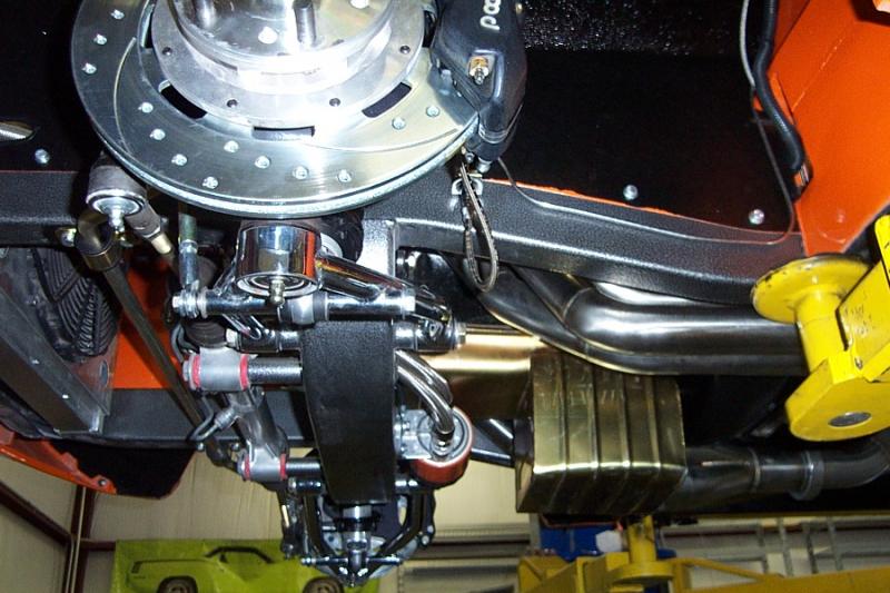

This car has Willwood manual 4 wheel disc brakes. The pedal is very easy to push and the car will stop on a dime.
Manual brake cars use a master cylinder that has a different bore size than a power brake master cylinder. I also believe in some cars they use a different pedal lever assembly to gain more leverage as you step down on the brake pedal.
The advantage to manual brakes is that you don't have to worry about adding a vacuum canister or vacuum pump to get your brakes to work if you are going to run a big cam that doesn't produce a lot of vacuum.

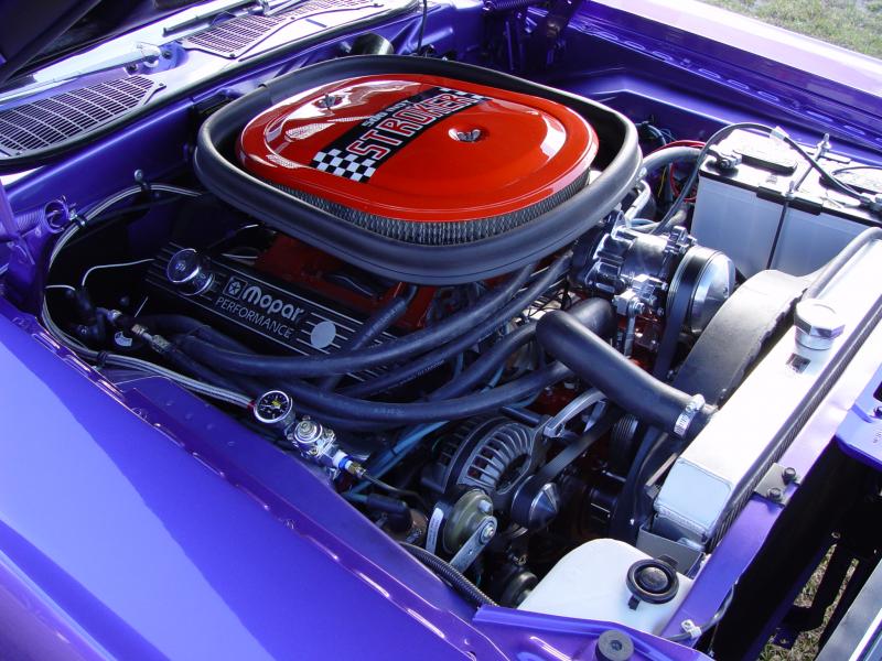

One other little sneaky thing we did with this car.............. Check out the paint on the air cleaner. My neighbor used the same style font and colors as the "440 Six Pack" decal and hand painted / air brushed the letters that no say "500 INDY STROKER". He also used the Indy logo where the "Y" is a side view of a cylinder head valve. When it was done I sprayed it with clear.
Just an example of some subtle little changes you can do with your car that don't really hurt anything. We have had people casually look at the engine at car shows and slowly walk away. Then they get about 2 cars over and they finally realize what they saw and turn around and come back to get a second look and make cool comments about it.
