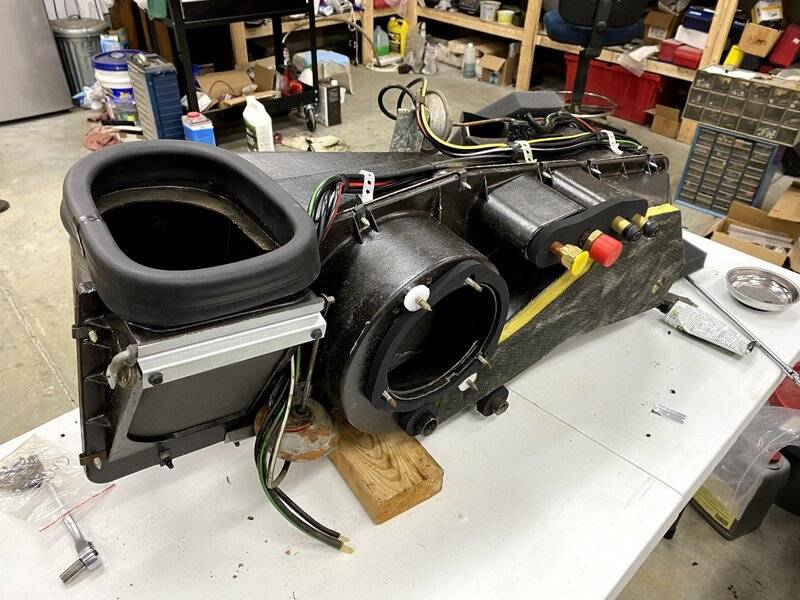

Since I missed removing a nut on the engine side, the air box did not come out exactly smooth and it tore on the back side. Has anyone refurbished their air box or found a compatible box to refurbish? I did not find anything new available for my year and model (actually 72 satellite).
Get the DMT kit and rebuild yours. I just did my 71. I sent the heater core to Glen Ray and the evaporator was new from Classic Auto Air.

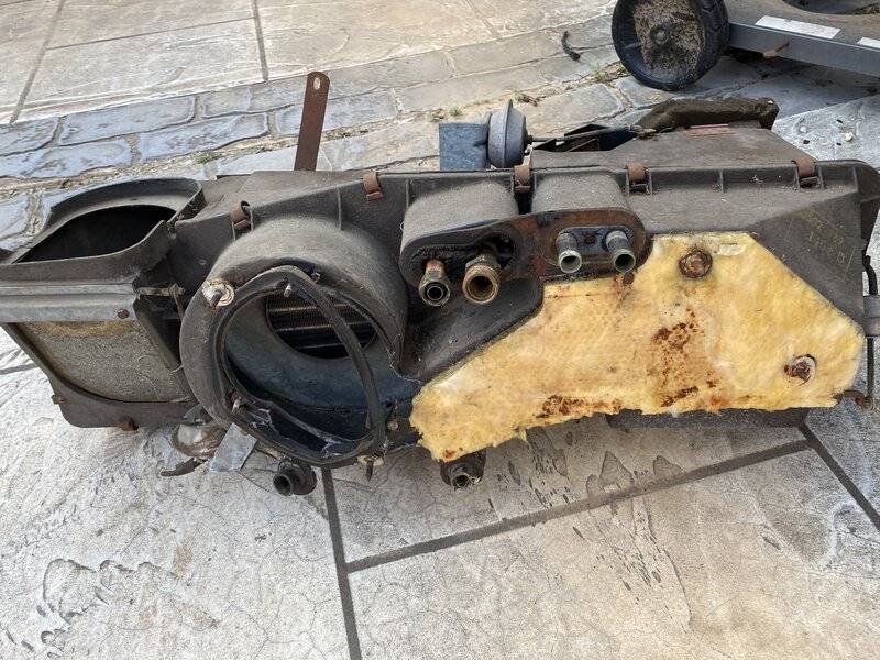

I refurbished my box using a spare broken box, used a Dremel to cut pieces and patched using JB Weld. I had a lot of spare parts because the two that I received through the mail ultimately got damaged going from the US to Canada.
I also used the DMT kit.
