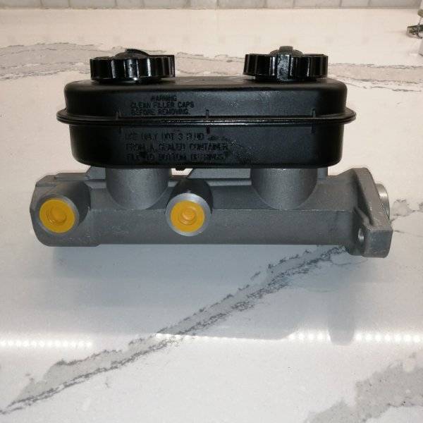

I purchased this modern aluminum master cylinder from a known good ebay seller.
I have questions about the outlet ports
I have read the aluminum master cylinder has the port farther away from the fire wall is for the front brakes . Is that correct? If so that would be reversed from my cast iron dual master .
Working on a 68 power brake charger for my dad . Just need to know if the modern aluminum master ports are reversed from the old.school .
Can't tell because of the black plastic tank does not seam bigger like the original had one big resivor.
Just want to do this correct and not mess up.

No they are nor reversed. Front reservoir is for the rear and rear reservoir is for the front. That's why the line ports are also different sizes.

Not on the master in the picture the plastic tank has equal. Size

The cast iron masters are the same as the aluminum as far as reservoirs go. Front is rear and rear is front.

The man who sold me the part for back to me and said the port closer to fire wall is front brakes and the master cylinder I bought needs no modifications.
Completely bolt on and For b body's cars

He is correct.
