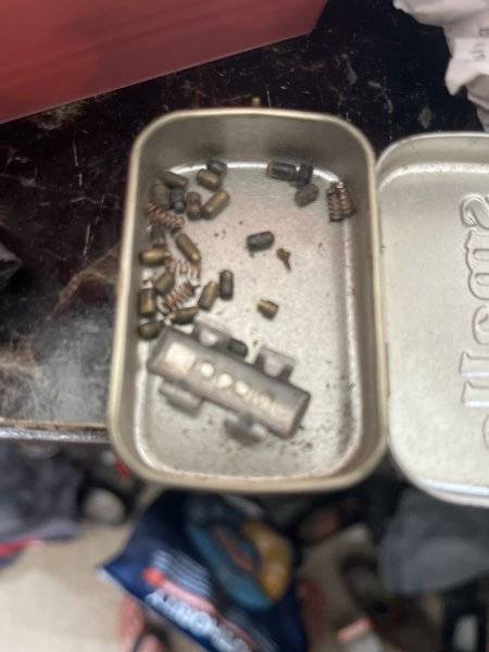

I did find a few threads and pictures. I have the original door locks that I could use to cannibalize pins from. If I can’t find a local smith, I might be learning a new trick LOL.
Just sit down with one (or two), and a egg carton to separate the pins by length.
...and start with one pin until the key turns, then move on to the next.
Pretty soon you will be correctly guessing what size pin to use based on observing the depth of the cut on that portion of the key.
