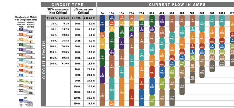

going to add the MSD relay to the coil. Based on the attached chart, do these wire awgs sound right:
relay to battery 10 awg (about 3’)
Relay to coil 12 awg (10 awg?) 5’
Ground 12 awg. 1’
Thanks!
relay to battery 8 awg
otherwise good.

Ur ground could even be smaller (#14), all it does is ground the relay.

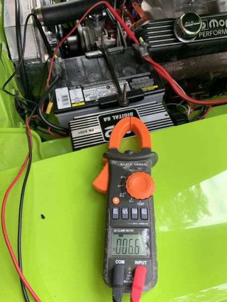

What do you have hooked up to the battery direct. Next put the clamp side of meter around the wire you wish to test. That will tell you the amp load of the wire. Try around the main cable at the alt at idle then run it up to 1200 you will see a difference.
It’s rare to find a DC Clamp Amp meter.
Your meter is reading AC Volts.
Some meters have Auto Voltage Selection meaning it automatically displays the voltage in AC or DC.
You might have to press the “Select” button to switch to DC voltage
Mine reads thru the clamp side on my voltmeter I didn't pay attention to the what he had it set on sorry folks.
10-4. I’m bad at electricity.
