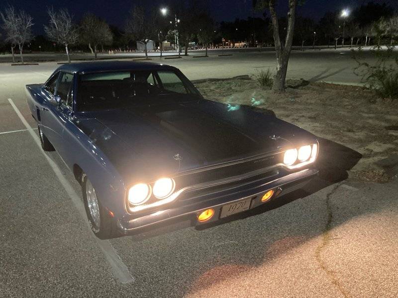

I have posted this previously...
There is a major voltage loss using our Mopar OE incadescent headlights and factory wiring. LED headlights are less dependent on voltage and draw significantly less current while providing a brighter, wider light dispersion. For my choice of LEDs I went with the Holley retrobrights, pricey but high quality. See the attached pix..
Just my $0.02... :thumbsup:
