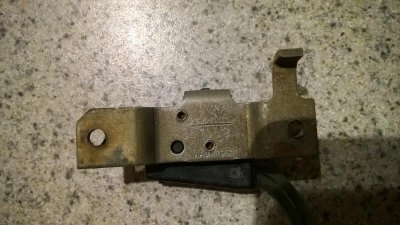

While I was looking for the hold open switch, I found this.The one wire was broken off. Now, what is it? I tried to upload photo's but, no luck. I'll keep trying

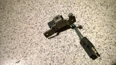

These are the pictures I was trying to up load. While following advice on finding switch. I found this. What is it?

that's a headlight limit switch in the front grille to stop the motors from turning...that being broken will not cause your relay to get hot..I bet you have another bad limit switch up front, or the buckets are out of adjustment to contact the limit switch...
again, I suggest getting a service manual on this system and read up on it...there are 2 pages of troubleshooting diagnostics in there for just the rotating headlight motor system
the headlight hold open switch is on the left side of headlight switch..it controls the ground to stop headlight motors from turning closed

there are left and right side switches.....makes a difference

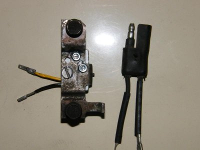

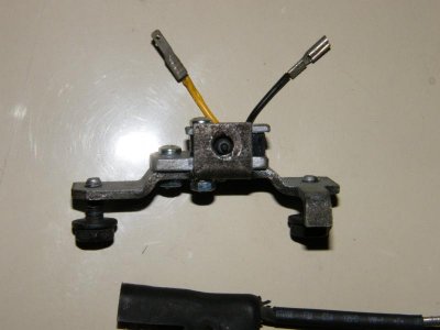

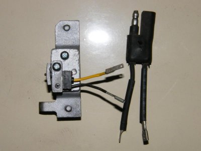

you can rebuild the switch by yourselve. it´s not that difficult. you only have to find a matching micro switch, the rest is a little work
i did it this way for my charger, the switch costs 3€.. it´s a waterproof switch for automotive use.DSCF0512.jpgDSCF0513.jpgDSCF0514.jpg

you can use other switches too, but it must be a switch, which opens the connection when pushed. also the push button must be long enough to reach through the hole, and the adjusting screw can push it. the buttons of the most switches are to small.. i had to buy some different switches to find this wich works.
