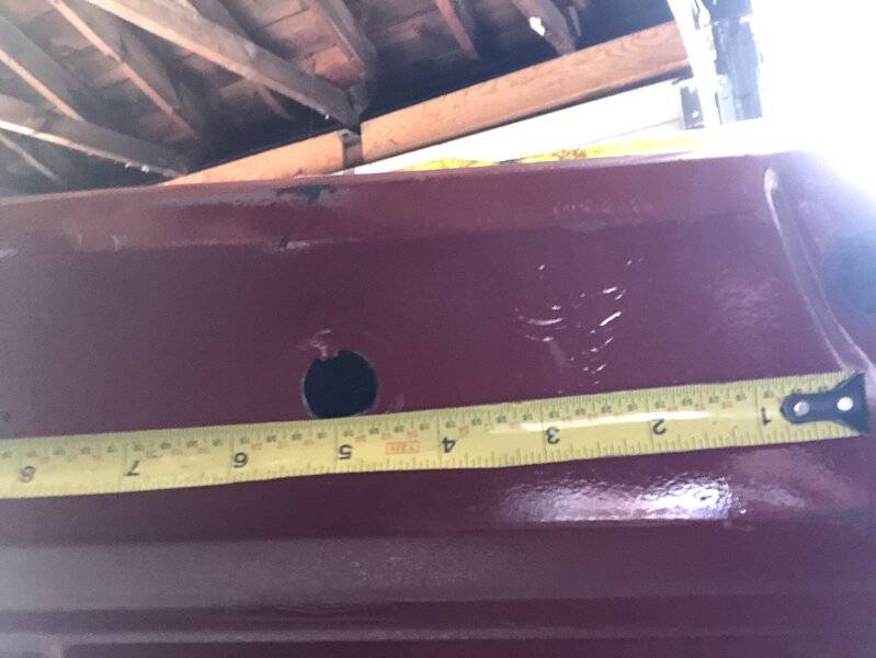

Putting a remote control mirror on my 66 Satellite that didn't previously have on. I need some locating dimensions to help put it where it belongs. Thanks! Mark
I can measure but not until tomorrow. Will post with a photo of that helps

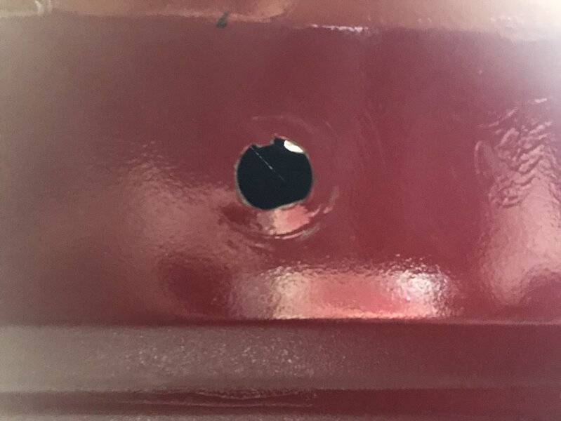

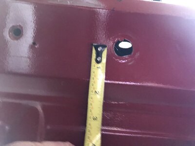

Here are the pics. Hope they help. Note the little tab and flat spot in the hole for the level
Hard (neigh impossible) to make a hole like that without a punch.
.....and a damn steady hand along with a good template.
I'd be tempted to buy the harbor freight electrical knockout and grind the flat into the male portion, then fill in the female side with JB weld or something.
I would simply drill a smaller hole in the middle then work outward with files forming the shape of the hole in the photo. But that’s just me.
