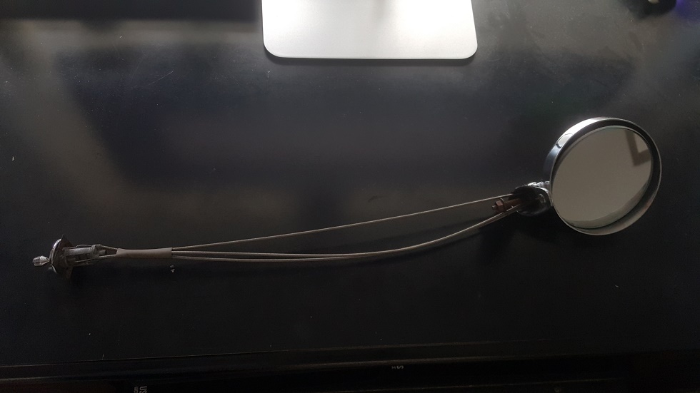

Like this one?
This was on my 69 Charger, but I replaced it with a repro from Classic Industries. The wires measure about 17.5" from the base of the mirror (where it sits on the door) to the lock screw where it mounts to the inside of the door. Hope this helps.

Yes, that is very helpful! Thank you very much.
