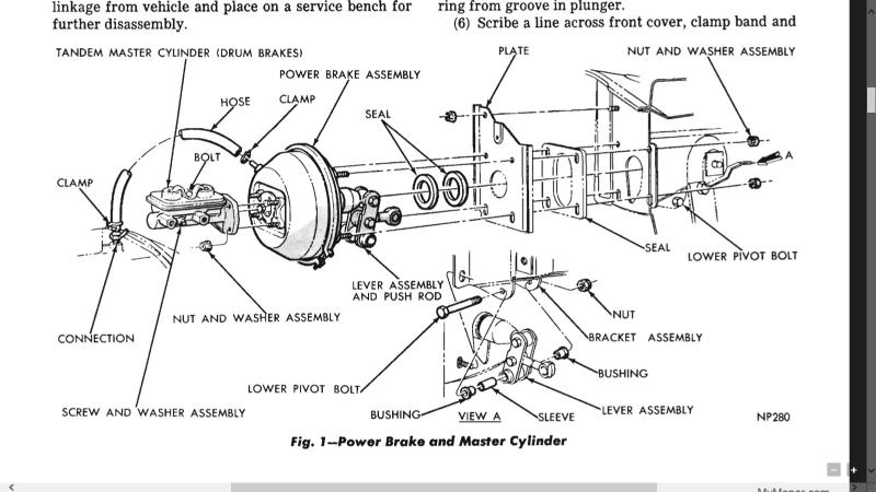

Hello i have a 66 coronet that i have to replace the booster on. ive been able to remove the 4 nuts to release it from the firewall, what i need help with is how do i remove the brake booster rod from the brake pedal to release it and so i can remove the booster completely. Any help would be appreciated.
Does this help?
pedal rod stays in place, you need to detach the rod that goes to booster to the top of the Z-bar to get booster off firewall...you don't take the rod out of the booster, that comes out with booster as a unit
