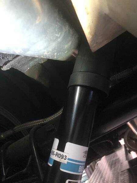

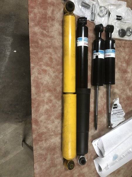

I was replacing my Monroe Gasmatics with Bilstein shocks. Problem is the shocks are extremely close to my exhaust. The Monroe’s were all metal, but the Bilsteins have a plastic dust cover that it is right next to the exhaust.
Can I just cut off the plastic cover or do I need to get different shocks?
The exhaust temps are much lower at the rear of the car and the material used by Bilstein may be just fine. Just like silicone is what is used on spark plug boots next to the headers. A lot hotter there than at the back of the car. Bilstein should list the temp rating somewhere, maybe their website. I can't imagine that they would not know about the exhaust pipes proximity to the shock absorber.
Thanks! I’ll check with Bilstein on Monday. Not open on weekends. I’ll check the web and see what I can find

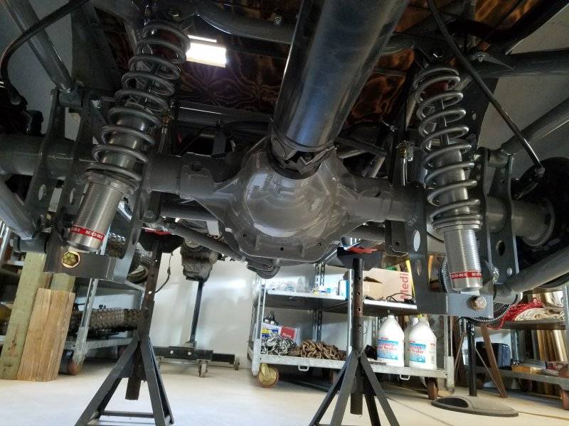

With coilovers (no boots), the shock body
is typically mounted downwards and are
also mounted in locations that are more
exposed to road debris, but the springs
help to deflect the rocks. I'd venture your
longevity of the shocks would be greater
without the boots. Open to debate I'm sure.
