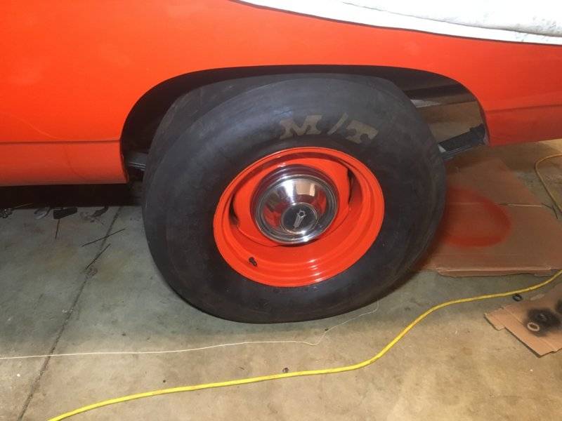

Just put steelies, painted my body color with hub caps.. Question:
Does anybody know how to remove hub caps without scratching painted wheels??

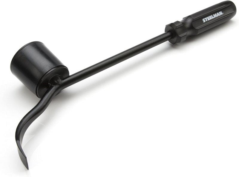

^^^^ What bm02tj said. Tape the tool and pad the rim for protection.Soft rag or sock.
I use a long breaker bar and wrap the end in doubled up heavy terry cloth towel. Same for area that contacts outer rim.
