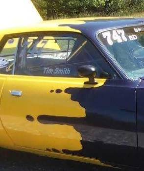

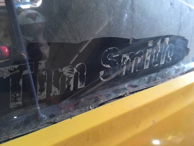

As my car gets close to being ready I want to remove the previous owners name from the side windows which are lexan. The windows are nice & clear & I don’t want to damage them. Would prefer a household product or something I can get at a local store.

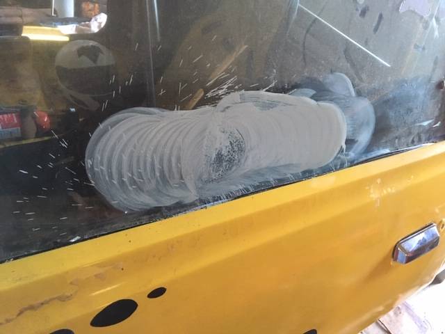

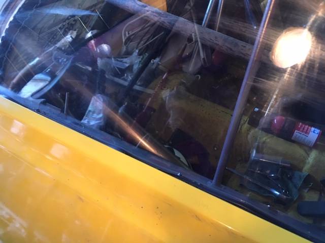

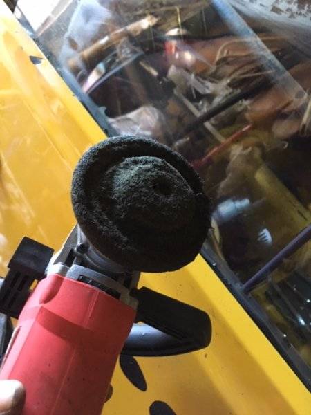

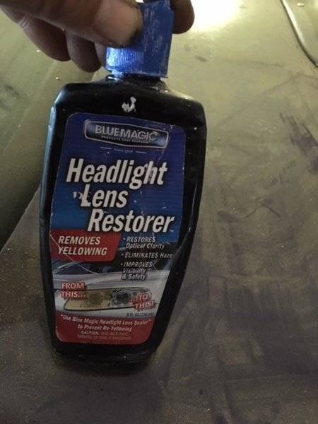

Tim is gone. I ended up buffing it off with headlite Polish. And a small soft buffing pad. Took about 20 minutes per side. Came out very nice. Took my time checking often to make sure no damage.
