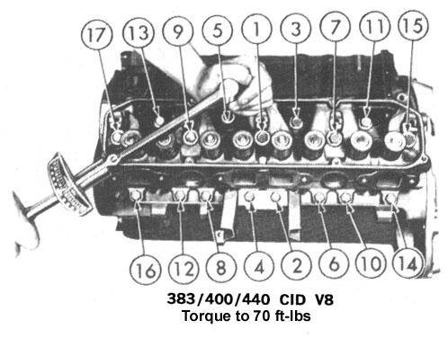

Right, I meant on each side. 8 on the outside of the block (16 total), 4 on each head by the intake runners (8 total) for a grand total of 24 bolts removed.
Here are the bolts you need to remove:
7usVblfhUZp6JkHH-_P004K_FwDfdw0OCQBjjbp_gXyEfMqUbOBc8B3coSlLlFT9W3rjXRTd2CuduNKDNo--ZhgC.jpg
You sure you got all the bolts? There should be 16 per side. Total of 32.

You got the ones from under the valve covers? They may be covered with gunk.....
Thank goodness I asked before forcing it. As y'all can probably tell, this is my first serious engine work. I missed bolts 17, 9 1, and 7. As Big Bad Dad predicted, they were under a layer of gunk, dust, and dirt. The weather turned very cold, so I'll report back likely tomorrow and let y'all know how it goes. If they're still not budging, I'll try 69a100's trick.
