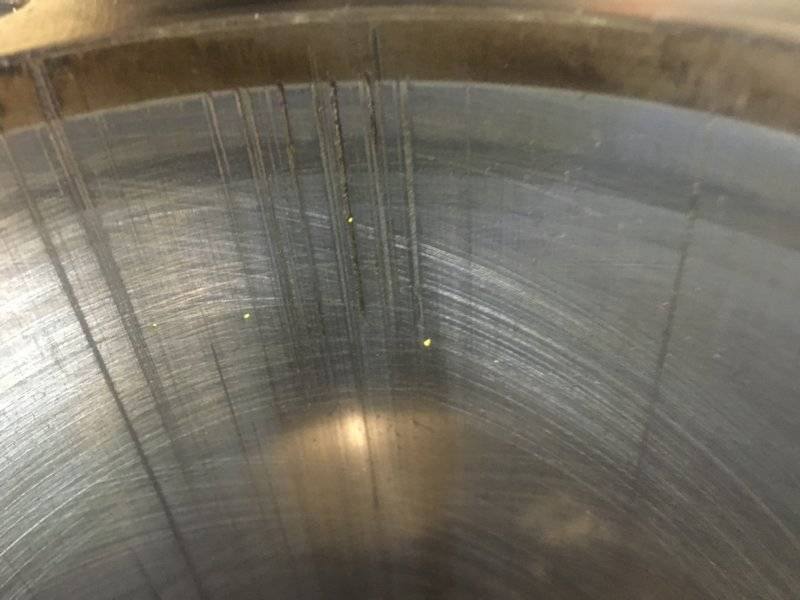

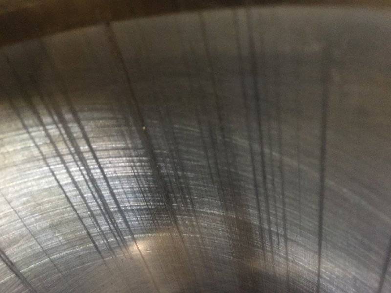

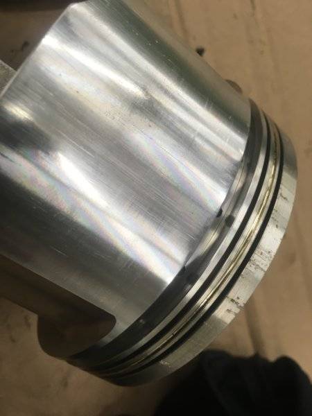

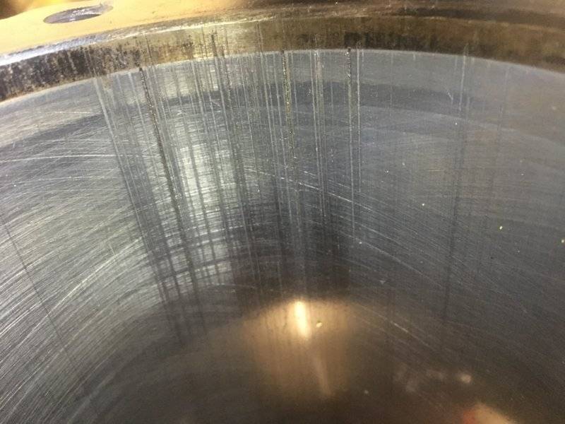

So I had some serious **** going through my motor. The block is junk as the scratches are way deeper than I can bore but I think the Pistons are salvageable. The crank, rods, and all the bearing surfaces are untouched but the cylinders seemed to have take the brunt of it. I have no idea what happened as I have not found anything in the filter or oil pan but I recently acquired the car from my buddies estate so I’d like to reuse the parts I can to keep costs down. All the damage seems to be above the piston rings which I know was the least crucial area for sealing. I’m thinking with some really fine paper knocking the high spots off and reusing my forged aluminum pistons. What do you all think ? I have included one piston which was the worst one and a couple of the cylinder walls which are garbage. The block has already been bored .030 over and with a stroker kit I really don’t want to run .060 over plus I’d like to save my $700 Pistons. The skirts have scratches that I cannot feel with my fingernail but the top ones are pretty decent.
Wow, IMHO the only way to reuse pistons is to sleeve the block. Price? 50/50 either way. Fresher block or new pistons; not really up on machining costs.
Sleeve the block. Is that the only hole damaged or is that average for the rest as well?
No sleeving.....6 of the 8 holes are like that. My buddy has a virgin 1972 std. bore 440 I will grab and bore it .030 again to match my pistons. Rings were all fine and no sharp edges.....had to be metal of some sort. My rockers and shaft were all chewed up, so maybe that went through the cylinder walls? Anyway I am just concerned with reusing pistons due to cost and the fact they are balanced with my assembly. I do not want to run a .060 overbore and chance thin cylinder walls with my 500" stroker kit.....besides these scratches are huge and will not clean up I do not believe anyway. I work in a machine shop and am pretty good at gauging depths or scratches and these are DEEP! I am going to clean the pistons up with 1000 grit then micron paper and go that route I believe.
You already know, but just to remind...be sure to dig all bits of steel, out of the pistons. Or, you'll look a more scored cylinder walls.
Yea I am going to soak them in my clean tank after all my sanding and polishing to clean them up nice.

Tape the ring lands off and use glass bead (low pressure) on the piston skirts. Polish them after with red scotch brite soaked in mineral spirits or wd40. Or you’ll have to dig the metal out with a pick. Glass beading is the better way to go.
I don't have access to any glass bead blasting, but I can use the red scotch brite on a wheel at low rpm at work.
Dig the metal out first. Then Use the scotch brite by hand. Polish the surface with horizontal motion to how the piston travels. I lay a soaked scotch brite in my palm then use the other hand to stroke the piston.
It is an aluminum piston and doesn't look like there is any metal in it....you mean the edges of the scratch and get it "flat" before polishing? Also you mean polish the piston the opp way it travels in the cylinder bore or same direction?
Now I see what you mean....Little bit of steel left in the scratches. I am picking that out with a dental scraper......good thing my sister is a hygienist haha!
OK give that block a few strokes with a RIDGID hone and see what happens how many thou to clean up?
Oppisite or across the skirt if that makes sense.

Have the block checked. A 0.060 block will be fine. Just have it sonic tested to be sure something odd isn't going on.

Check in to Swain Tech Coatings for coating the skirts on your pistons.I have used them for years for skirt and dome coating with great results.Our Nicom -chrome cylinder walls were tough on pistons.We used Swain Tech coatings saved our expensive top pinned pistons from looking like yours.If they are still round,get them PC9 coated. So slippery oiled can’t hold on to them!!!
