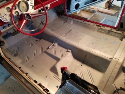

I cut a set of the reinforcement plates out of a 65 Satellite last fall should you want to try and add something original looking. How effective they'll be probably depends on where the anchor points are on the new seats compared to original buckets.

My thought would be to design something like that to avoid flexing.Thanks for the pics.

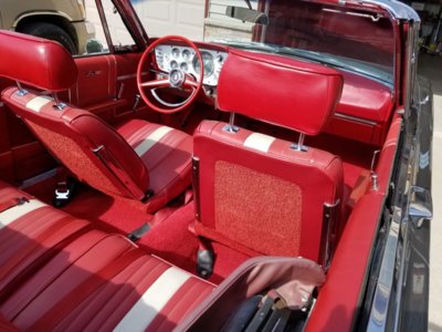

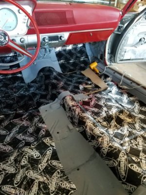

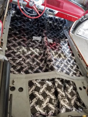

I found stock seats. Attached some pic's. I ended up getting headrests installed on the buckets despite these being seats before rests came out as it was less of a hassle as it worked out finding nice late 60's rests on eBay for cheap. Had a neck fusion so needed the head protection in case. You see the seat brackets like posted above as installed on a few of the photos..

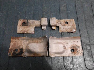

Or you can buy these for $25.00 shipped.....
After thinking over the situation I will take those brackets. If you want to send them that's okay. I could pick them up at your place or if not comfortable with that meet you somewhere. Let me know what you prefer.
That's a real nice deal on those brackets; I was glad I found them when getting the buckets when I did the install some 15 years ago but danged if I can remember how I globbed onto them. When I installed a modified console recently I remembered there's a slight offset since the driveshaft tunnel isn't in the center of the interior so there's a bit more gap between the tunnel on the left vs the right seat. As I recall the front brackets kinda takes a 'set' where they're supposed to be with the curvature. In any case the left seat does align straight on with the steering wheel and the gap between the seats and the doors are pretty even, well simply the outer holes for the bench were used for setting the location of the brackets. The stock buckets are wide so if thinking of new seats as I found considering new ones, many are narrower, some considerably so. I might imagine some extra checking for how they'd be set would be desired. Not sure; guys that have done this would know..

Procar has a wider seat on some models. Just need to check measurements. Even with the universal mounting bracket I am sure that some sort of work needs to be done to get them into the stock location holes. Thanks.

My car only had the reinforcements for a bench. Someone had put buckets in and the floor cracked over time. You need to have some structure/reinforcements there so the seat is supported and does not pull out/fall out at an inopportune time. I will be making a structure that gets welded to the frame connectors on mine when I get back on it.
