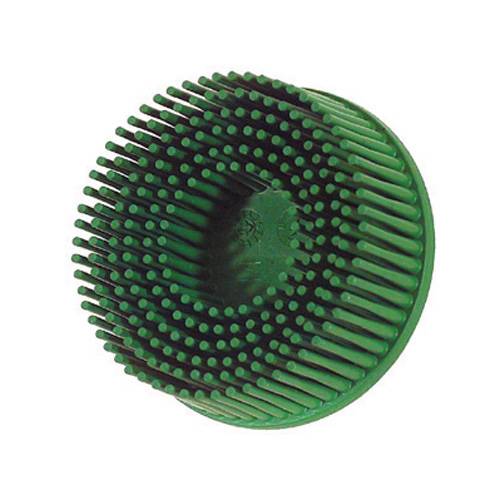

Then I like a wire wheel on a drill to get anything remaining off. It doesn’t remove material and make grit like either of the abrasives in the video.

those rolls disc are not recommended, especially in sleeved engines, the razor blade method is best.

I have done the razor blade and 5 way tool for cleaning up the surface. There are multiple ways to do it. Everyone will have their own tricks. Whatever you are comfortable with. The scotch brite method I have used in the past works well as long as you pretty much use it to get the gasket material off. I would not bare down on it for long periods of time in one spot as it will and does remove material. Watching the video above the shop manual says to do it the way he did it. But that may be to reduce shop time like mentioned above.

Roloc bristle discs.
